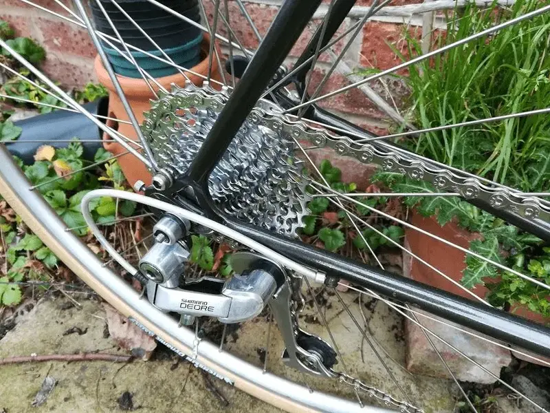

Currently am converting a 1990 trek 750 into a gravel bike and am putting full deore Xt drivetrain components on it. Any suggestions for STI levers that will work (well) with deore Xt m735 derailleurs 8spd ?

STI (brake/shifter) then you'll need to be mid/late 90s for 8speed XT to keep a full XT drive train.

Front shifting will be shit unless you have bar end shifters. The cable pull and reach is all wrong.
Aside from that, you can go mad and use a 10spd shimano right hand shifter with just about any SIS mech you want. From early 6spd Deore all the way to the last gen 9spd mtb mechs / 10spd road mechs , it will shift fine
