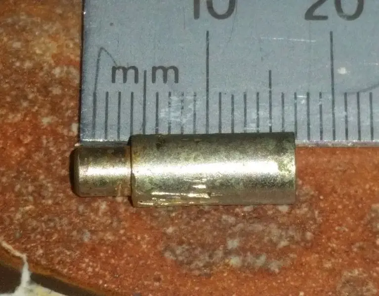

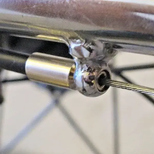

I don't think the stepped brake ferrules do a very good job and leave the cable quite sloppy. I have some stepped gear cable ferrules. I can't check right now but I think they are for the 5mm outer gear cable and step down to 3.7mm. They are for the Campagnolo divers helmet style of braze on cable guide. I'll post a pic tonight.
That's exactly what I need! The divers helmet is a goid description of the braze on. It is the same on my Dyna Tech as on my Merckx Corsa Extra so guessing Campagnolo pattern.

I think it was Campag who called it the 'divers helmet'

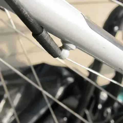

Not my pics but I have same as this....but cleaner like the second pic :) How it shouldn't be at the bottom
