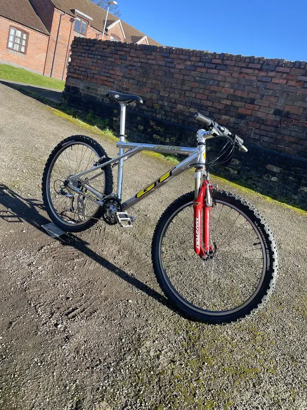

Just finished up my 96 Avalanche with a couple of upgrades. Only problem I have is the right shifter has a wobbly lever. It will only shift if the lever is pressed up towards the bars and even then it can slip.
