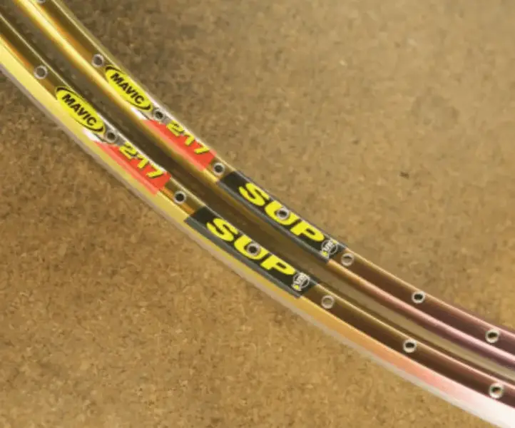

Hi there,
Don't know if anyone can help me on this?, Ive just found my ultimate rims a set of 26" Mavic 217 SUP Sunset rims New Old Stock, and I need to purchase the correct length spokes for the hubs I'm planning on using.
Rear rim has 36 Holes and will use either a Shimano Deore XT 7 speed, Hub M730 or a Deore XTR M900
Front Rim has 32 Holes and will use either a Shimano Deore XT Hub M730 or a Deore XTR M900
was wondering if anyone can help me with what length spokes I would need?
Ive tried looking at the calculators, and the best one Ive seen hasn't got the details of the hubs I plan to use.

I recently built some wheels with those rims and Shimano hubs and I used 262,264 and 265 mm spokes. My hubs are both 32 holes. I think most Shimano hubs have the same BCD (a bit bigger on the rear).
Yes, Shimano hubs are all the same. even the 6/7/8 speed doesn't really alter it enough at the rear to worry.
I think, but check . 259/260 for the 36 rear.
Probably get away with 260 for all, or better 258/260
Worth a check your ERD of the rim is 540mm though.

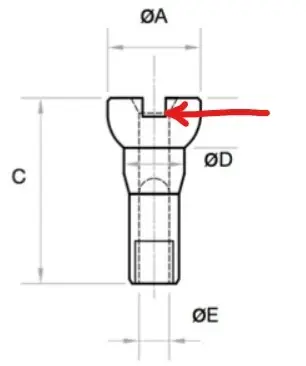

Where do you like the ends of the spoke to end up? Flush with the top of the nipple when at the correct tension?
At the same time I was wondering what people's experiences were with DT 535 rims for bicycle touring. I have a Shimano XT 737 hub and paired with a DT Swiss 535 with an ERD of 540 would give me 261 mm on the L and 259 on the R.
In a perfect world, flush with the bottom of the slot rather than the top of the nipple.
In the real world, some will be spot on, some a bit short, some a bit long. That's just the way it is 👍
