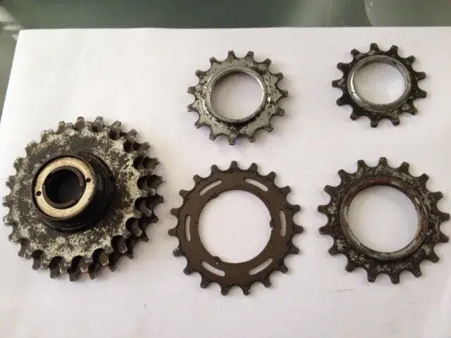

Still looking for a nice spread of gears for my raleigh banana, I bought a 7speed 13-25 freewheel. I wanted to split it, and mount the sprockets on my existing body, 13 and 15t sprockets were threaded, but with a little 'persuasion' they came off, 17 and 19 were unthreaded as I expected, but 21 (5 of 7) refuses to move. Have soaked overnight in wd40, and succeeded only in breaking the chain whip chain! Do you think this sprocket would be threaded?

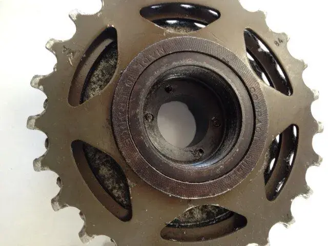

Hi guys.
I'll make a slight correction - first three sprockets were all threaded (13-15-17) but it cant be a coincidence these are all slightly corroded steel, where the 19 that was unthreaded and slotted is a different finish entirely, and has almost no corrosion on it. You guessed it, the troublesome sprocket (21) is indeed corroded steel. Pic from the back show 25 and 23 as slotted and same gun metal finish as 19.
So I guess It looks like its threaded...
Any suggestions on how to free it ? previous technique had been a short length of scaffolding slotted over one of the chainwhips, and application of elbow grease. It seems to need more strength than my whips will cope with...

i can't quite make it out from your photos, but if that end sprocket on the body doesn't have the three wee notches shown on the other ones, then it has to be screwed on.
The green one is a "compact" version. A 5 speed body, and with the green spacers and special other cogs it is made into a 6 gear. The number 3 is indeed a threaded one. And probably a 6 speed body can be changed into a 7 speed.
biggest 2 are splined, 3rd one in is threaded, 4th splined, 5th & 6th threaded. 7 speed requires a different 6th smaller sprocket into which the 7th threads (ie 7th doesnt thread onto the freewheel body, it threads into the next sprocket up which contains a second internal thread).
They will index with shimano 7 speed systems or campag 8 speed.
