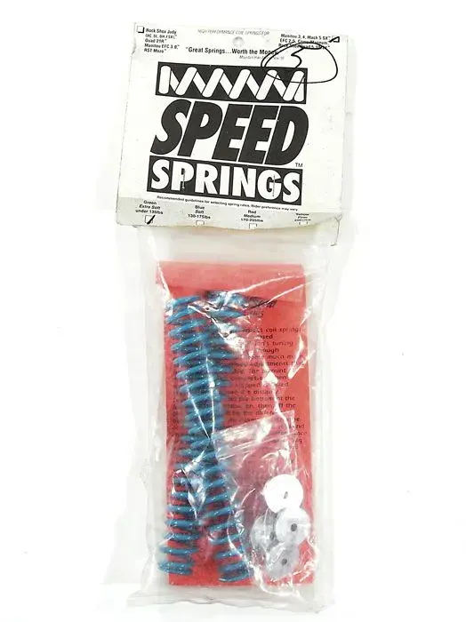

would these have been used with or without elastomers
Without the elastomers and in the damped judys. You could always run one leg with the elastomers and one leg with the springs. I did this on some old RSTs and it worked wonders. :twisted:
in the description it says they will fit all the 95 elastomer forks
manitou 3 , 4 , rock shox Q10 , 21 , 21r but not the judys
could you get the oil / air cartridge for the manitou
knew you could for the RS
I have a set of 95 Judys XC , and they have elastomers in each leg and a cartridge in the left leg .
There is same number of elastomeres in each leg , so you could replace them both with your springs and leave the cartridge .
All Judys ran an oil damped cart.
The manitou 3s were elastomer only. Run the forks with these and you'd have yourself a nice pogo stick :D
If you're talking manitou 3 (not sure on the rest) you'd have to run one leg spring and one leg elastomers. Not sure how well it'd work.
thats what i thought at first
but......why are there two in the pack
you would be getting two bikes worth , not many companies that considerate .
BOGOF or buy one get one free.....????
( yes i work for sainsburys :( )
Didn't read the packaging properly, saw Judy in top left hand corner and thought they were for Judys. :oops:
