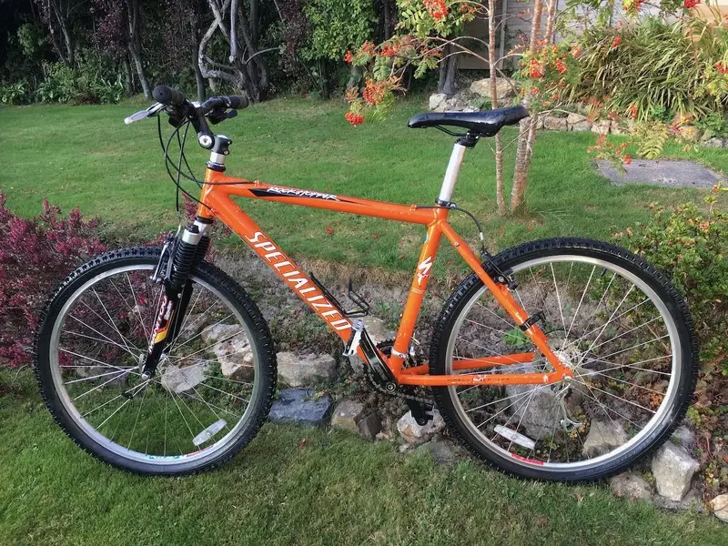

Thanks for your message. I've re-measured and it's actually 19in from bottom bracket to top of seat tube.
It is odd, as when I sit on it, it looks small compared to my Orange. Maybe I'm not used to the sloping frame design. Comfortable to ride though. I'm just looking for a cheap second bike to knock about on for a while and the frame on this isn't bad as far as I know.

How long is the top tube (from the centre of the seat tube to the centre of the head tube)?
Aside from that, it looks like you would benefit from raising the saddle and as for that adjustable stem . . . It looks like it's been set to about a 70 degree rise! Try adjusting it to just a shallow rise: that will increase the reach and make the bike feel less cramped. (In due course, if you keep the bike, you might want to replace the stem but, for now, it might be useful for trying to find a comfortable riding position.)

The stem is some quiet cheap adjustable one, which just won't adjust and is fully seized. I've just removed it.
Any thoughts on a decent replacement stem? I happy to check Ebay for a used one in keeping with the bike's age or a decent but not overly priced new one.
Cheers, Ian
You can pickup period correct Specialized stems quite easily on eBay, you’d need maybe a 120 to 130....but then it’s all personal preference at the end of the day.
I run a 120 on my 18” Stumpjumper
