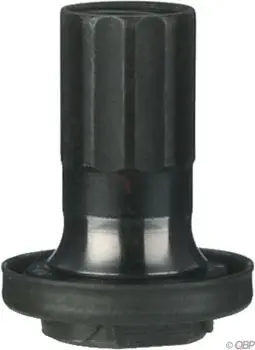

Is this what you're after? If so I'm sure I have some of these at work.
Anthony":3n7tno4l said:
Well, that was indeed enlightening, but how about this then?
http://www.petracycles.co.uk/6400-seal-ring-p-5637.html
It's the seal from a Dura-Ace HB-7700 and both the seal and the lock nut look very similar to those on the HB-M950. And it's only £0.99!! What do you think, could they be interchangeable?
http://techdocs.shimano.com/media/techd ... 611785.pdf
I can only say maybe. On the one hand, you'd think Shimano wouldn't use a different seal with its own part number unless there was a good reason. I did wonder whether it was because the M950 uses 11 balls per side and so has a larger dustcap diameter, but the 7700 is also shown with 11 balls per side, and seems to use the same seal as the 6400 and 738.
Obviously the way to be sure you get what you need is to match the part exactly if you can. Perhaps dbmtb can help, or failing that, surely someone must have replaced their cones at some point and kept the old ones.
If you can't get an exact match, I've got hubs here I can measure when time permits, including a Dura Ace 7700.
