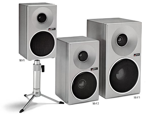

I am currently running some aluminium Technics SB-F2 - they are from around the hifi golden age of 1980, extraordinarily efficient and have little or no cabinet colouration (where the cabinet material resonates to add to the overall sound). They are combined with a Richer Sounds sourced Gale sub.

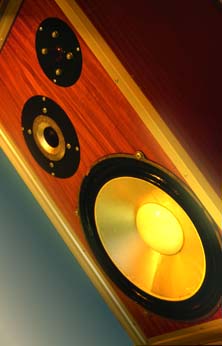

If I were on a budget and retrocentric, I'd look at the Mordant Short Carnival series, shallow cabinets hiding a large efficient driver:
