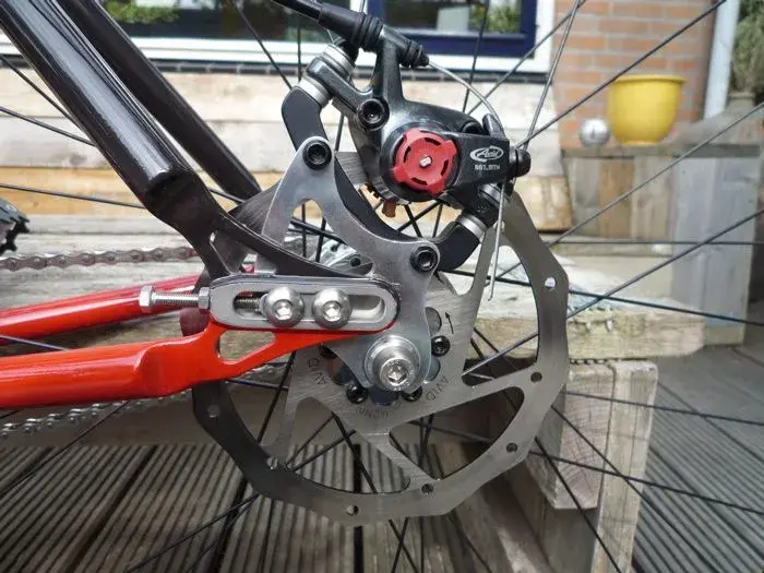

The good thing about the Paragon's is that the brake calliper moves together with the wheel. This avoids all kinda adjustment problems :wink:
afraid not , result of a google search where a forum had a " post your singlespeed " thread and ive long since deleted the favourite link
could be mtbr forum though if you want to find other pics , there was one other where the wheel was static and i think another of the complete bike so you could see the manufacturer
I think you may find that retro-fitting the Paragon sliding dropouts to an existing frame either means specifically resetting the seatstays to suit or living with a considerable increase (30mm +) in wheelbase.
I obtained a drawing from Paragon in order to mock-up a couple of dropouts out of thin sheet just to see how the geometry would all work out. In my case (95 Explosif) it just didn't (without a lot of work to the seatstays) and I decided not to go down that route.
If you look at the Groovy pic with the Paragon sliders you'll hopefully see what I mean - if you imaging cutting off conventional dropouts and grafting on the Paragon, the axle position will either move back or the seatstays have to be set to a steeper angle to maintain the same chainstay length.
