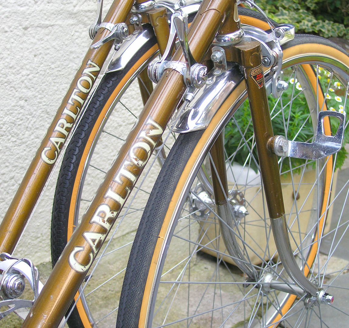

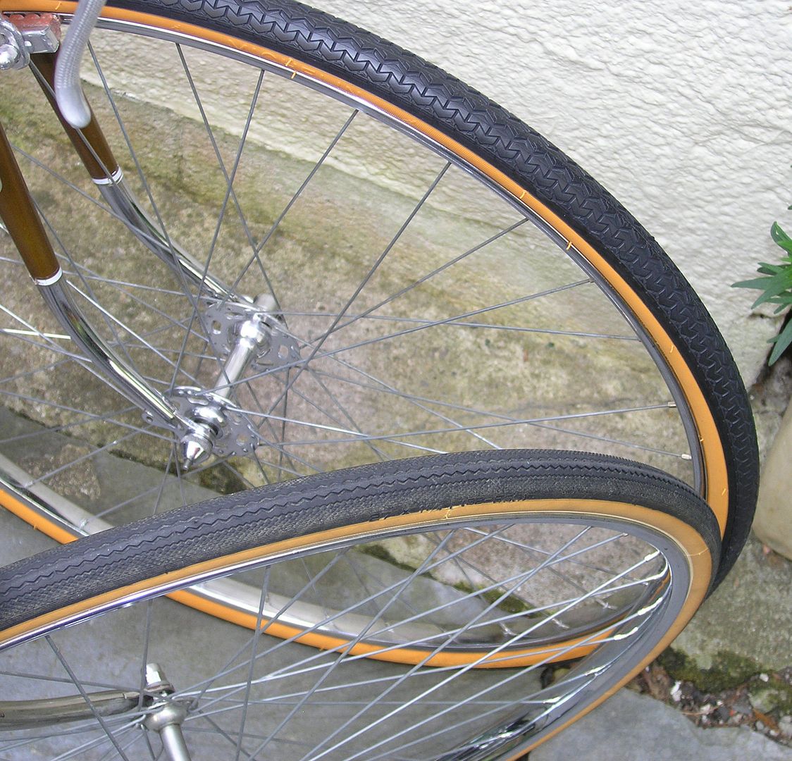

This may help, these are two near identical Carlton Criteriums, ones has Pasellas the other WTs...
Thanks. They're a bit thinner, but not with a chiseled profile like some tyres that I've seen on modern bikes. Given that difference, I'd be inclined to use the WTs until they wear out then reconsider my options.
