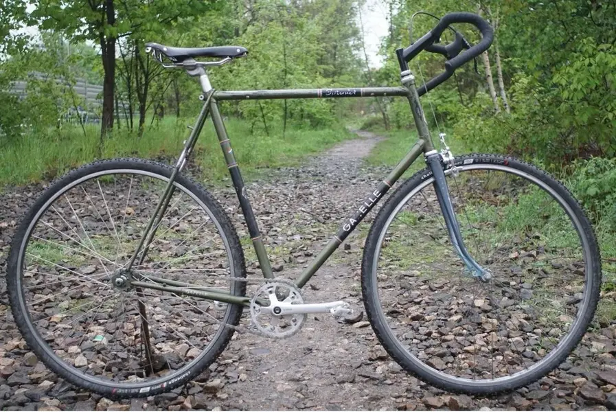

First one was an 1970s Gazelle "Sprinter" with a wooping 64cm (ct) seattube and a rather low BB - set up like this, I rode a 160km race on it fixed gear:
With 87cm (34") standover height, it is a good inch about my inseam (32.5-33).
While on the bike riding, I haven't felt any discomfort, also the TT was indeed pretty close and getting of (or on the bike) wasn't alway easy.

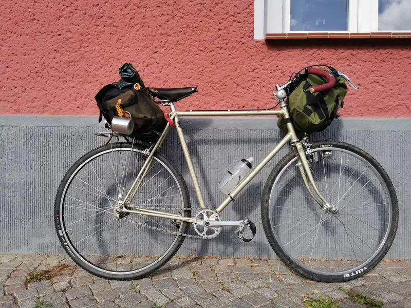

Ok, I thought, I'll give a smaller frame a chance. A Raleigh Record Ace from 1982 turned up, with 60cm (ct) BUT a higher BB. Getting out in the woods with it recently, I felt the same way riding it than I did with the Gazelle. Meassuring the standover height revealed a suprising 87cm again.
