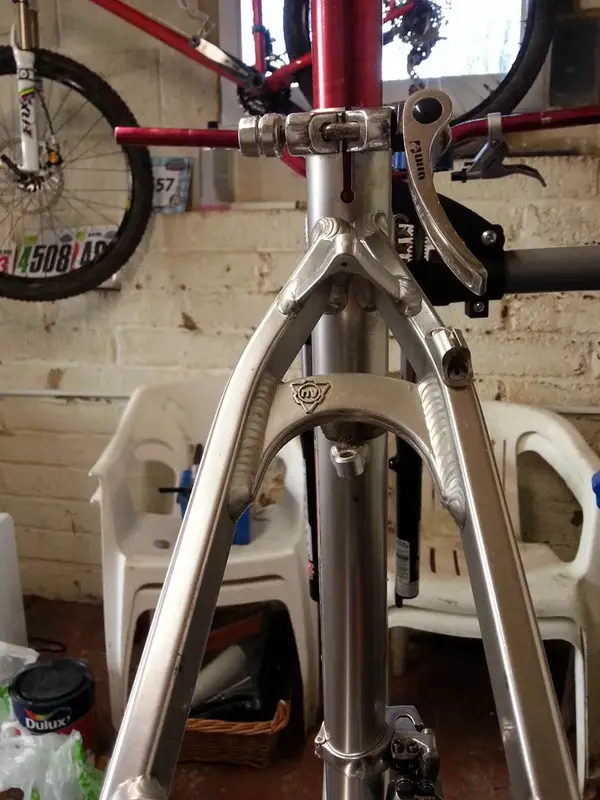

I’m not sure how much discussion, if any, there has been about this year’s Brighton Big Dog? Well, this year they’ve dropped the Retro Bike category….

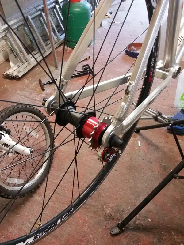

Of the ‘Odd ball’ categorises remaining, there is only the Single Speed. I kind of feel I need to represent Retro Bike at the Big Dog this year, so I thought I’d enter the single speed cat on a retro. The best part of all, it gives me an excuse to get another bike!
Long story, short, I bought this Sentesi Thruster on Ebay, which seemed like a decent enough bike for the job. The thing is, I’d never heard of Sentesi before I bought this and there is very little information online. I believe this is a 94-95 bike?

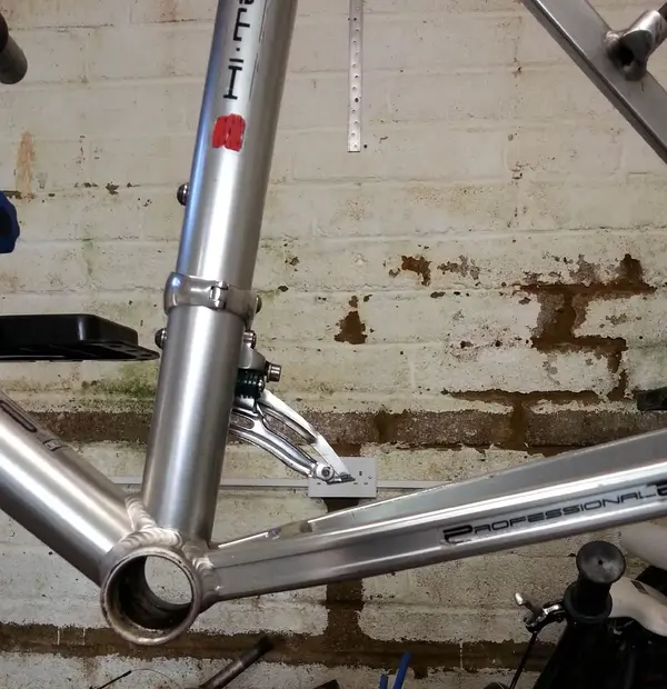

I’m hoping for some information as I build it up for this year’s race. First of all I need a bottom bracket. I’ve measured width (68mm) and diameter (34mm) but I’m not sure what to do next. I’ve some spare square taper cranks kicking about, but don’t know which BB to go and buy. On Chain Reaction they have a multitude of BBs, some of which have ‘Italian’ threads? As this is an Italian frame, would I need this kind of thread?
I should probably add that it came with those forks but no heradset, I'm in two minds about the forks. Keep or ditch?

Re: Sentesi Thruster 95 (94?) some assistance please
I like these frames, twice I've nearly bought one, as for information, as far as I know these will be all standard English threads, you most likely wont find much searching for Sintesi thruster but if you look for Verlicchi you'll find several variations on the same frame with different decals such as this Rudy project branded one viewtopic.php?f=6&t=143312
Most likely English threads. On Italian both cups have a right hand thread and are larger.
Yes and search for 'Sintesi'!
Heres what they also used to make:
file.php
file.php
Yes, Sintesi, apologies. I'd read the correct spelling several times but stil contrived to spell it with an 'e'.
It came with a Sugino Mighty 900 crank set, which I thinking of using. Any ideas on spindle length for one of those? 113mm?
Sugino mighty 900
Spindle length? The bottom bracket shell is 68mm. I've been on Sheldon's site but this doesn't seem to be on there?

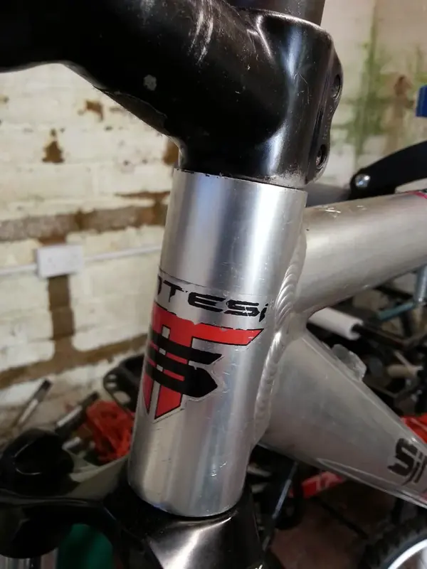

Yo!
Recently picked up the same frame, and i have some questions about the headtube diameter.
Is it 1 1/4"?
I've measured the bore of headtube (where the cup sits) and it meassures closer to 40mm than 37, so I don't know what size headset I should by? Been looking into getting a reduction cup, to take it from 1 1/4 to 1 1/8, but I don't know if it fits and ec37 headset to begin with?

Hi Oliver
1-1/8" according to the catalogue here -
https://www.retrobike.co.uk/archive/1995-sintesi-catalogue.1294/download
