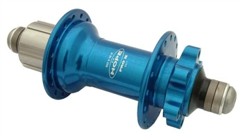

Hope singlespeed/trials hub.
It's just like a normal cassette hub but with a narrower freehub body.
You can fine tune the chainline with the spacers.

Agree with the Hope...nice hub with the advantage of flexability of chainline over screw-on freewheel type hubs. If you wanted screw-on freewheel type...Paul Words are the way to go...beautiful and light.
