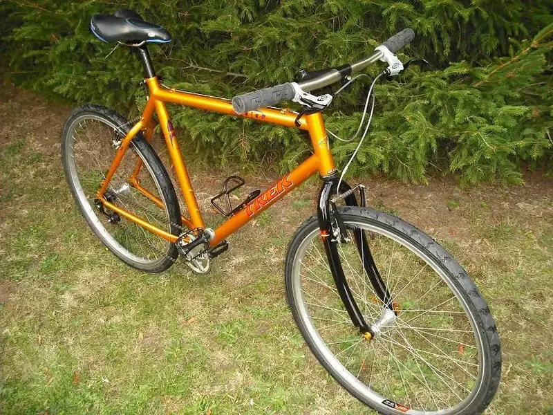

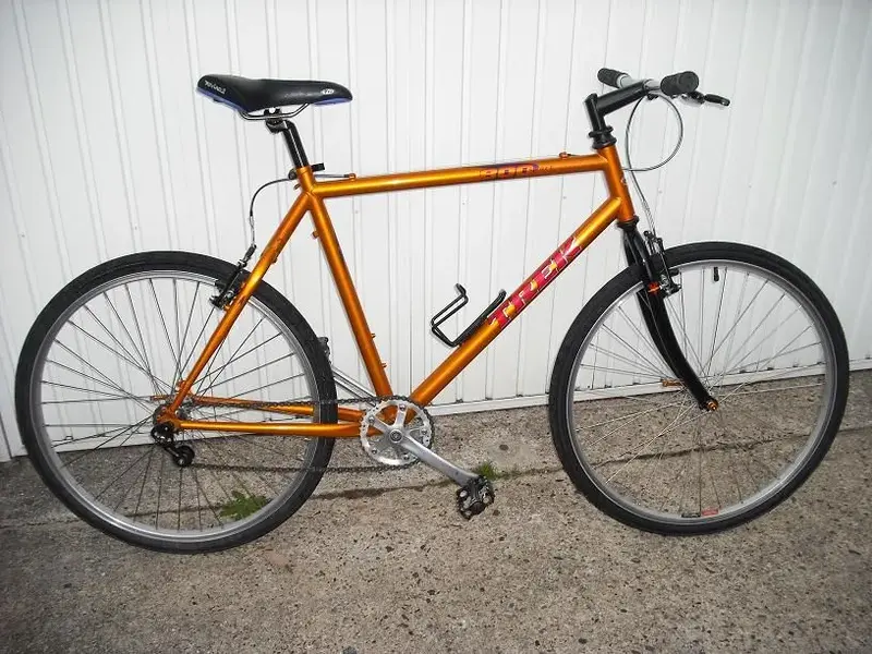

Single Speeding is a simple process, I was able to convert a TREK to single speed using an old dismantled rear cassette (Retaining the spacers) and by removing the two rings from the Crankset cobbled myself together a pretty effective Single Speeder, the only thing i needed to take up the slack was a chain tension device which I found on ebay el-cheapo. fitting some Schwalbe Cityjet tyres & losing the excess weight of the front and rear mech and shifters I was soon tearing up the town center with ease. It does take some getting used to but was loadsa fun. I can see why they are so popular in inner city enviroments. Functional, Clean and very Low Maint :D
Have a go :)
Here is mine, sadly sold on now, but looking to make another one very soon.

The beauty of using an old Cassette is that the smallest and largest ring are usually the ones that wear out before the rest, With a 8 speed or 7 speed cassette youve got a few options to try out by experimenting with the different 'Teeth' combinations, coupled with a budget chain (Incidentally i paid £4 for a chain from ASDA) which worked really well. I've seen sprockets and tensioners for under £20 on ebay.
It can be done on a budget, my TREK is testament to that.
