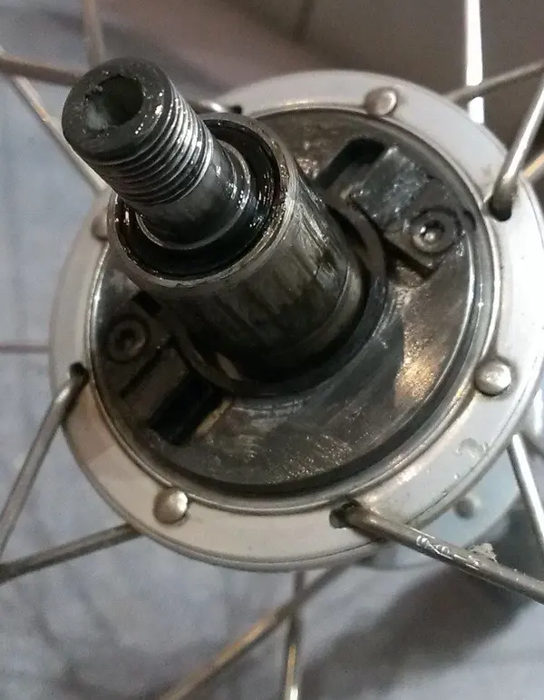

Might have this freehub- can you post a pic of the hub on your wheel so I can check if mine matches, as I can't remember the model.
Ah, it's bad news I'm afraid- I can see my freehub won't work with your hub. The hub I have, although similar to yours, is a different model. I thought there could still be a chance that the freehubs would be compatible, but seeing the interface pictures above, I can see that this is a no-go due to your one being designed so that a large flange actually seats itself inside the hub, whilst mine has no internal part. Bad luck:) I hope someone else out there can help.
I am not surprise, as I have been told that these are like hen's teeth!
I think my Cosmics are early 1990s, and the freehub has s proper bearing at the hub end rather than the bushings they had later.
My quest continues...
Many thanks for looking anyway.

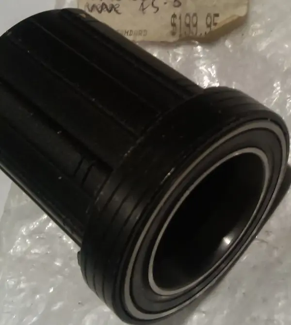

argh , I have owned a NOS one that I sold only last week to a guy in Perth Australia

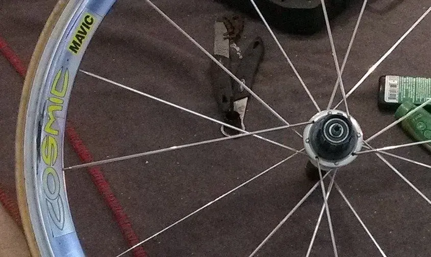

hi folks, exactly the same issue. a set of Mavic Cosmic Pro wheels set up for 8 speed campy, but want to run them on shimano. I bought a mavic shimano freehub body, no good.
http://www.ebay.co.uk/itm/161777932781?_trksid=p2057872.m2749.l2649&ssPageName=STRK%3AMEBIDX%3AIT

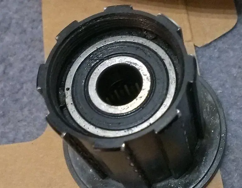

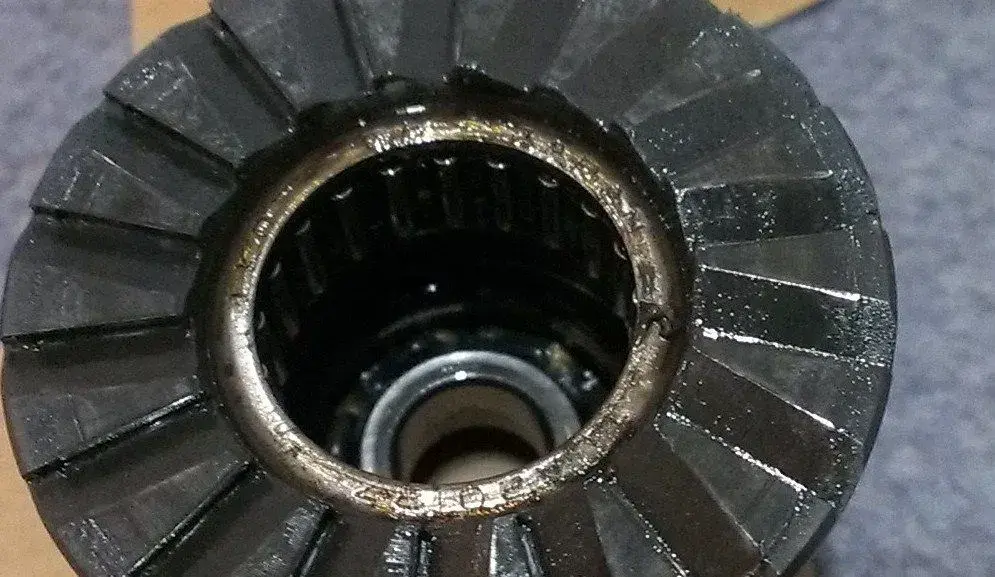

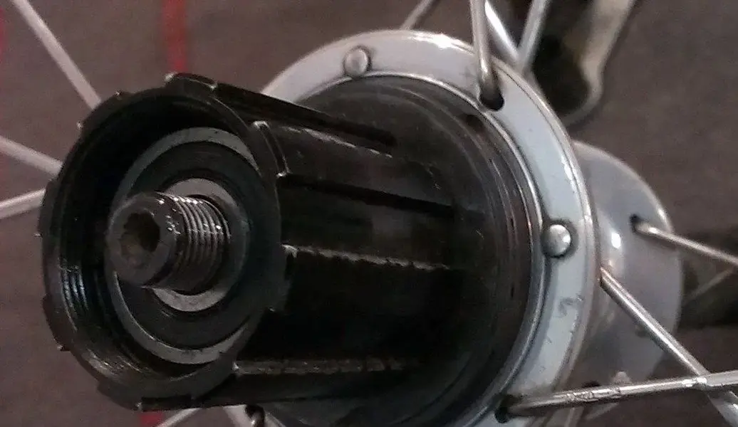

here are some photos of the campy free hub and mavic hub I have
Basically, can I get away with fitting an 8 speed shimano cassette to the campy freehub- I saw somewhere that an 8 speed dura ace might fit (please exactly which one), or would an old 8 speed xtr?
Is there a shimano freehub out there that is compatible with this wheel? Its a cool wheelset and I'd like to use it if possible.
Also I run a weird set up of ultegra shifters, xt cassette and xt rear mech on my other wheel set - all 9 speed, would that set up cope with 8 speed if I could get a shimano cassette to fit??
thanks for any advice.
