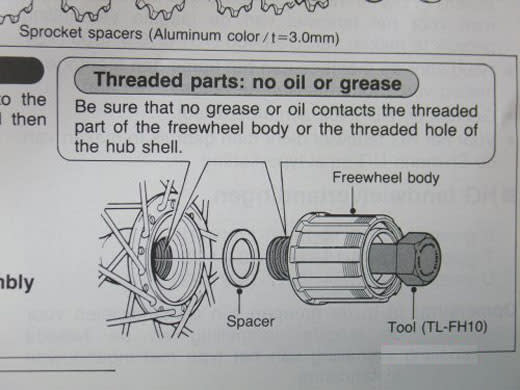

Shimano DA 7402 Freehub Alen Key Size
rusty bodie
I thought that it was a 10mm allen key to remove the freehub body
off of the hub - NOPE! Does anyone know better?!
They were different,Rich at work will know.I will ask him in the morning pm me to remind me.Think I've got two new free hub bodys with instructions will look.jm.
You need a TL-FH10:
http://velobase.com/ViewTool.aspx?ID=79 ... 2109b124aa
http://tinyurl.com/p9m7vn4
TL-FH10's are hard to come by I had to make a tool used mastic to make a template of the spline pattern then got creative with a M12 bolt and a angle grinder :)
Jeez, that's a fortune - for all the times that I have to remove it, I think I'll just take it to the bike shop - he leant me the tool last time and I returned it when the job was done. Thanks for the links tho'.
