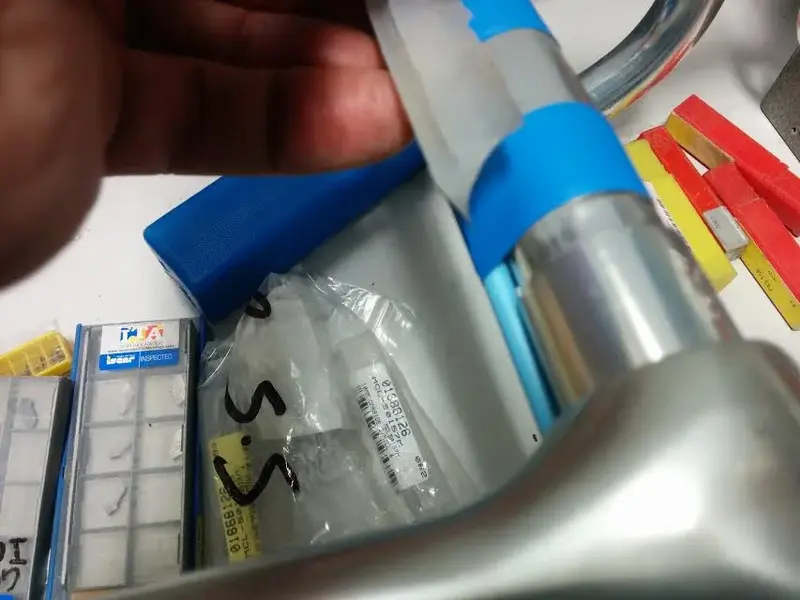

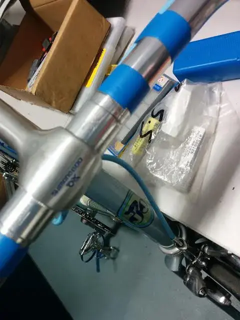

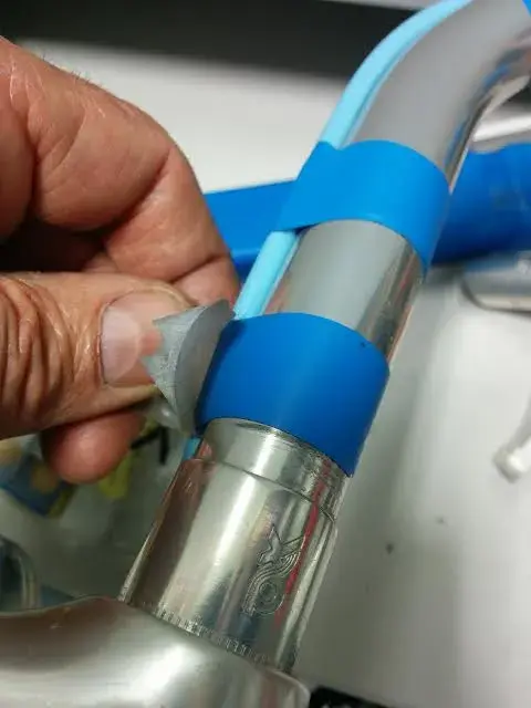

There is a rubber cable support that goes under the bar tape. I understand to give a more aero trailing edge to the bars.
Q..............was this rubber infill for use with the AX bars that are oval ish anyway? Or was it was it for standard round bars only?
By the way, I think I can produce this section, I'm doing myself some first.
Ta
TP

On the plain round bars on my Raleigh it had something very similar to that fitted but it's on the fronts of the bars.
This is a perfect sort of job for the 3D printer. Another reason why I should buy one.
That stuff is for round bars! I'd search for the correct grey foam stuff which matches the oval bars to make it even more aero.
Remember though by fitting this stuff you will go much much faster..............
