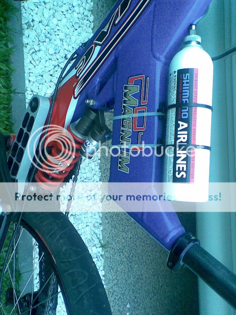

hi all , i never been happy with Shimano Airlines . in a few word it sucks, to speed of it useing , Air
when dose work very nice shifting but dose not last long ,
say you get 400 shifts they musting skomeing alot weed, good lucky get 75 at full power , and try to save air 150 to 200 ,
after 7 years own my first set, and break it, i my am god at pull this part and pull it back to how it was,, to get working so i know what it inside story now changeds
i got a 2 set i had not pull apart the rear mech part i want to let it stock, same thing has above Sucked shifting and very few shift ,
has i know all part were costom made from Shimano , and they burn all the old stock and part from i been told (
few years ago i pick up new seals, hopeing they get my first set working agian , i never pull the rear back in a work way, Dew to shity way they made it, i need to make costom brushing
and 2 set will need the same thing, before it dies, so i replace seals after market one, Holly ReTro Gods must love me, it work aigan, Better then before, :xmas-cool:
now How the hell i find a now rear cass , it's 7 speed, cass . i never to use a after market one now , it say max teeth 26 , too find out it bulll shit , wow it go up 32 teeth, )
to find out Dam it 9 speed spaceing, Wow this more Crazy only use 7 speed WHy ?
has i have 9 speed cass 11 to 32 on it i was able to shift the full 9 speed 2 times then it would only let me have 8 speed :facepalm: sill very helpful , i have a 28 teeth which i neeed very badly for my downhill bike to climd 7 km hills,
http://www.disraeligears.co.uk/Site/Shi ... 01%29.html
i like to know if any thing the same thing happpen to you, and plz tell your fixe's
All the best ReTro bikes :shock:
