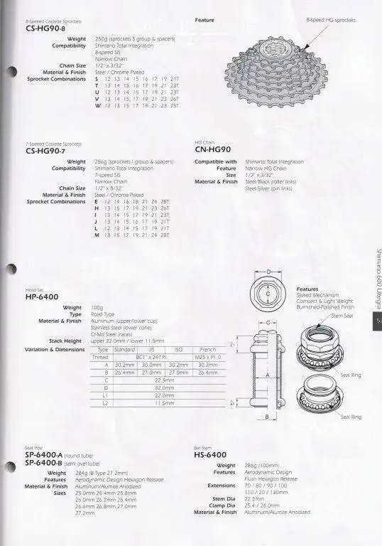

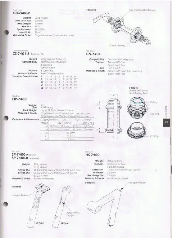

Velobase says 5/32" for the ultegra 6400, and 3/16" for the dura ace 7400 headset - can anyone confirm or deny those sizes, before I order some?

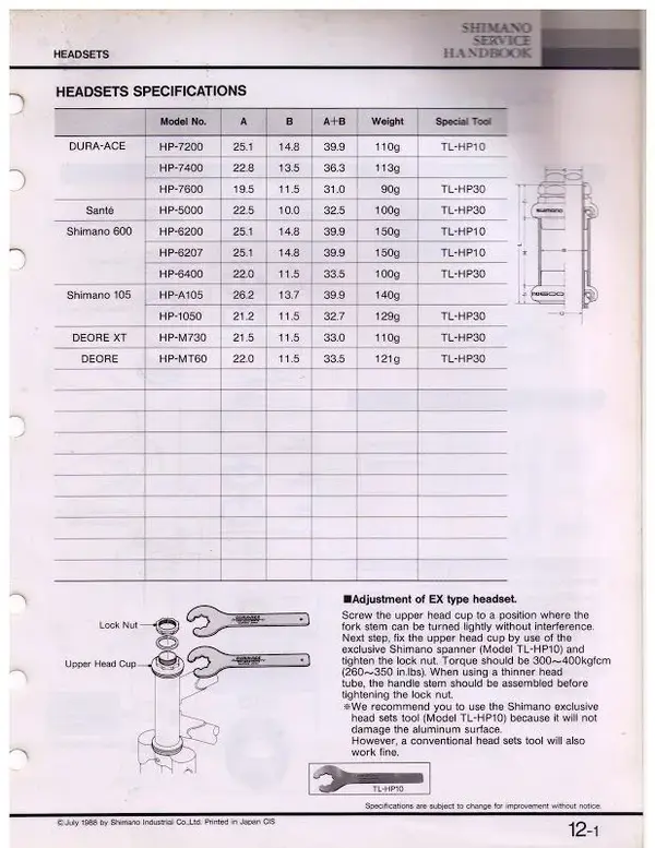

I thought the smaller bearings were for the 7600, ultegra 600 (whichever number that was) and the 1050. Related to the low stack height for the headsets, particularly the 7600.
Sort of copying the smaller bearings in the Campag Pista headset?

Shaun, the 6400 is shimano 600 :) It has a slightly lower stack height compared to the 7400, hence the smaller bearings... I have the catalogue info for both of them, but the actual bearing sizes aren't stated. I checked velobase, which is usually correct, and must admit that I didn't measure the old bearings yet.

Hi Foz, I learn something new every day :). All those blooming numbers!
The scans you posted sort of back up my memory that the lower stack height headsets have smaller bearings. The 7600 appears regularly on well known sites for hundreds of dollars being one of the smallest stack heights there is!
