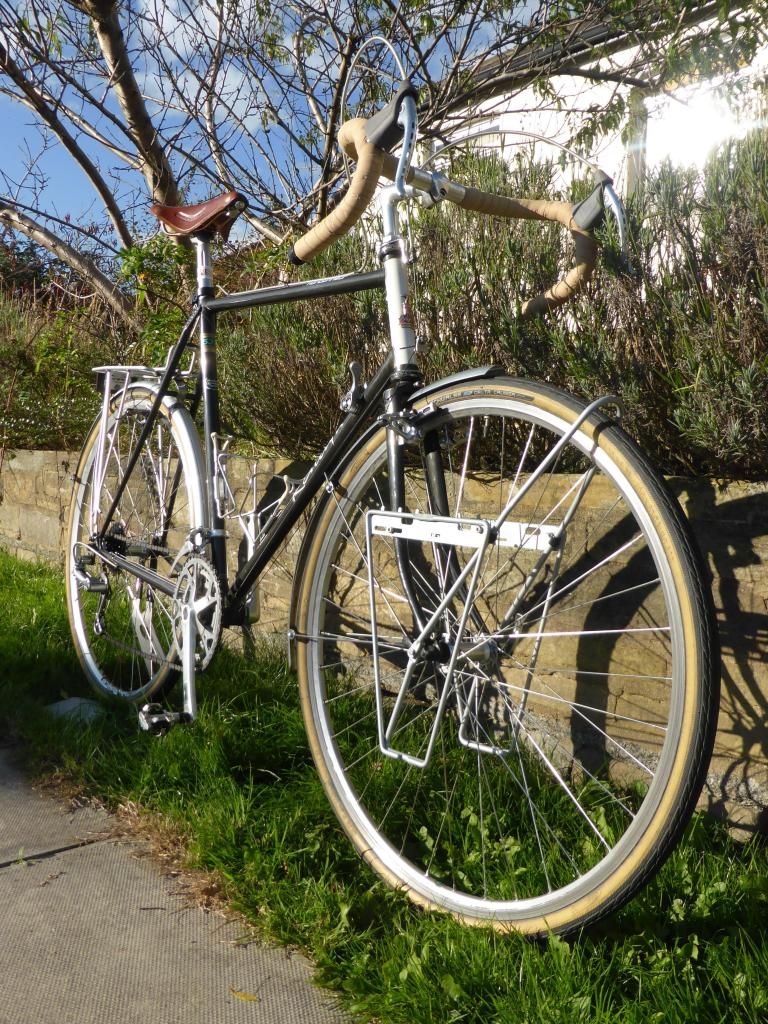

Last year I bought the Raleigh Randonneur below to replace my old Dawes Horizon which had been written off by someone right turning into my path. I've been gradually renovating it and at the same time accumulating parts for a temporary updating for a tour next year.
Anyway, one thing I've noticed with aero brakes is the greater mechanical advantage when braking from the hoods. So, as I won't be alone on the tour, I decided to get some aero brakes for the bike so that I'd be able to ride close behind my friend without being on the drops all day.
Now, I assumed that basically, a Shimano brake that looked like that below (ie the 600s on my Randonneur) would always be non aero and those with the hoods more integrated to the body would be aero.
Of course, I open up the parcel of my NOS shifters, less than £10 delivered, only to discover a holes in the top of the hoods!
So, the question is, aside from the springs, are these shifters basically the same as my 600s but with a more modern body or are they the same as the aero version but without the concealed cables? ie with the greater mechanical advantage from the hoods. Is it worth me fitting these (the springs should enable me to set the cantis to minimum tension which is probably a good thing) or do I go back in search of the aero version? I haven't found online a definitive answer to this. It's not going to be hard to swap these onto the Randonneur to find out for myself but before I do that it would be nice to know not to be disappointed when they don't make any difference!
