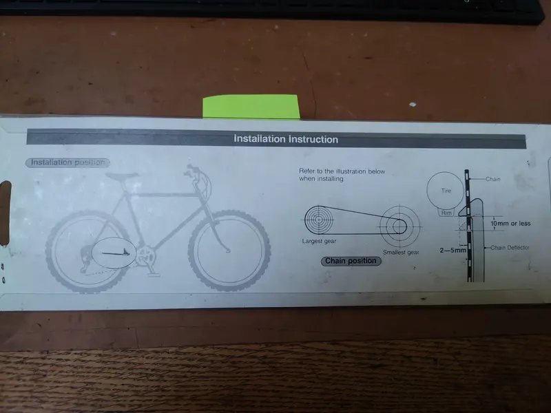

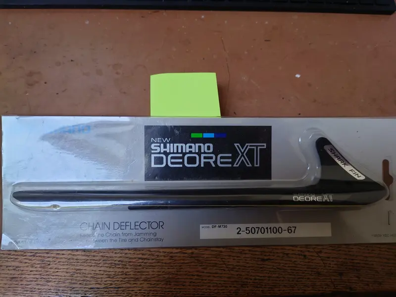

Most of these sharkfins now come to us 2nd+ hand, and so the original packaging has long since vanished. But as I have a NOS one that's about to go onto my current build I thought it was worth posting these simple instructions that appear on the back of the pack. It's not something I recall reading BITD, but it's quaintly informative.
