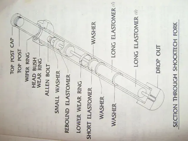

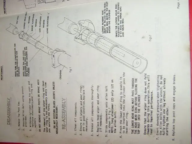

I've got a pair of ShockTechs which were UK built replicas of the Manitou 1, I've got the full manual in the garage, I'll try to scan an post it.

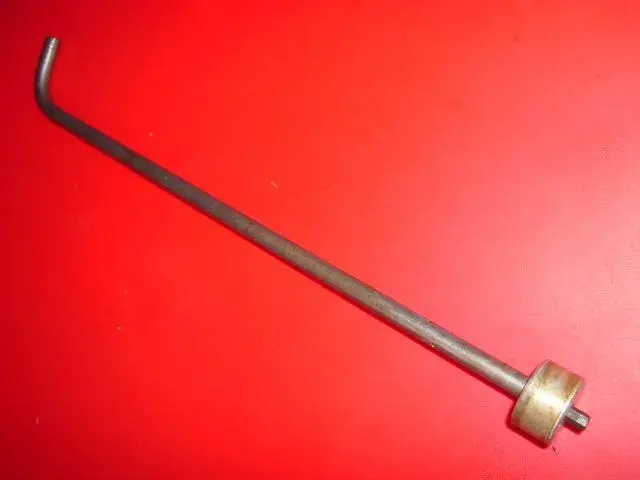

The tool ShockTech supplied for servicing is a piece of smallbore stainless with a 5mm allen key in the end and a round collar same diameter as the stanchion to keep it central, I'll photograph that as well!
Hope this is some good.
