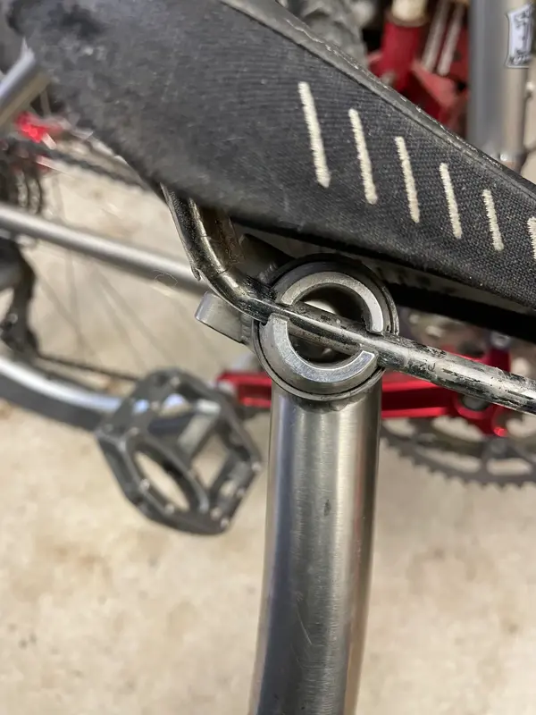

I'm using a Van Nicholas that looks pretty identical. You just have to open it up enough to be able to tap one of the cradles out then it comes apart. It was a faff last time I did it but I don't think I needed to lever it open.
If you have to, use a bit of wood (not a screwdriver!) - it'll only need opening a mm and the Ti will spring back no problem.
