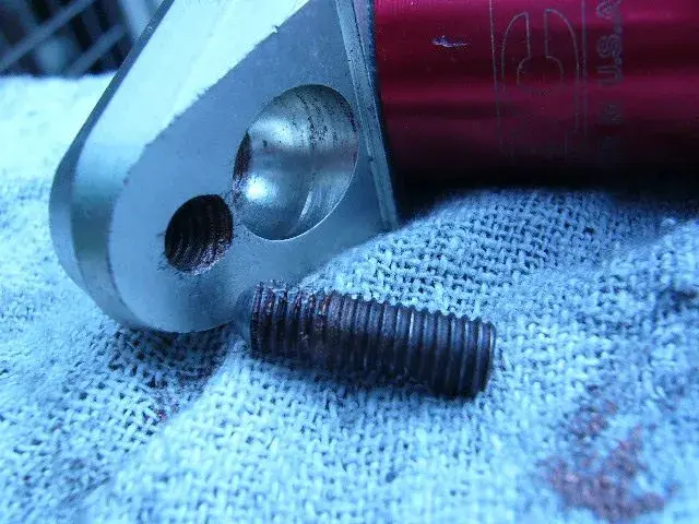

i have a ac seat post see pic the smaller adjuster boltb was stuck in seat post head i got it out but messed up thread on bolt only ..where can i get grub screw from ? or allen bolt to fit see pic ? cheers
grub scew
how do i findoutif its a m6 or m8 or m4 ? cheers getting closer to getting it up and on my ride cheerrs its about 2cm long and takes a 3 allen key any ideas ? cheers
does the stud fit into your canti mount thread,if so its an M6?
Or take one of the canti bolts out and compare the threads next to each other,they should 'mate' well
If its a 3mm allen key that fits it it may be an M5 thread
Yeah thats right,think the measurements are in mm though so 20mm length,tbh if youre not 100% sure id order 1 of each M5/M6/M8 for the extra 60p :wink:
