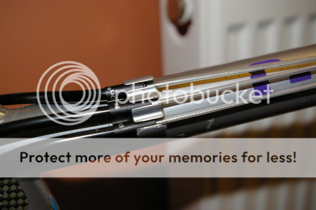

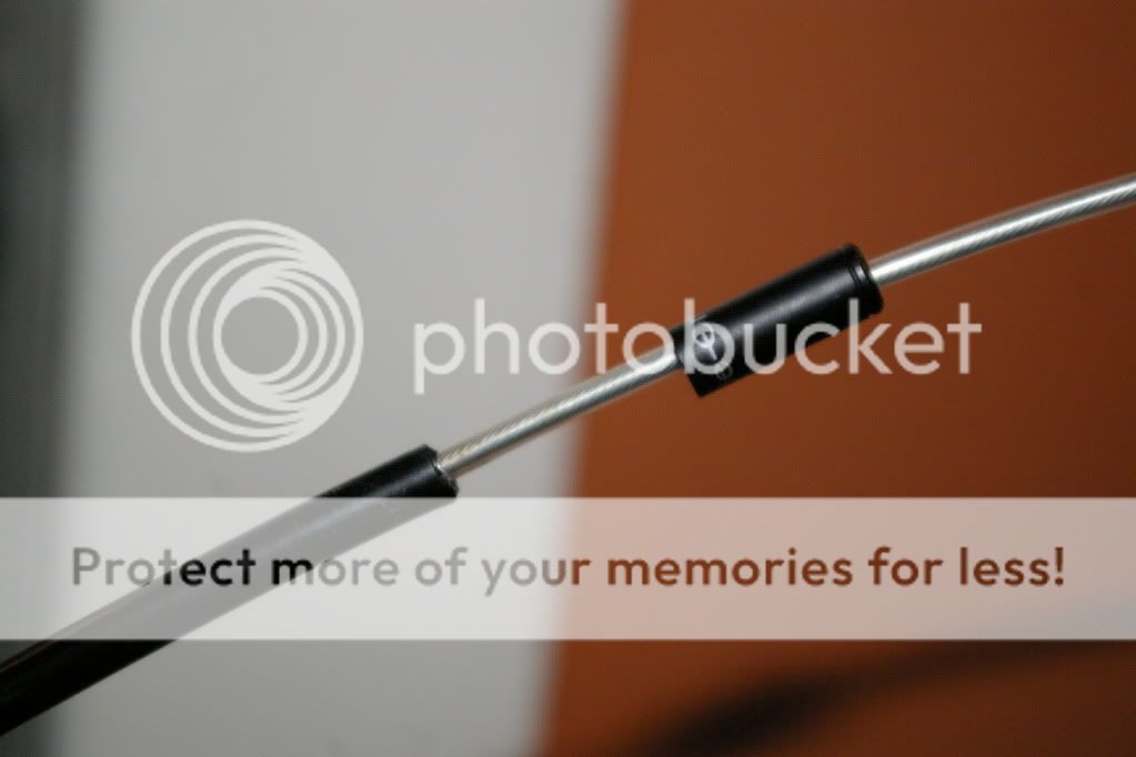

Just fitted some white Ride-On cables... 8)
They do take a bit of concentration to fit (it's actually easier than it looks in the instructions :lol: ) but they make a noticeable difference on my Intense Uzzi with it's long cable runs. As cornholio's RC200 says they feel like they'll be a 'fit and forget' part like Maguras. We'll see how they survive the Swedish winter!
