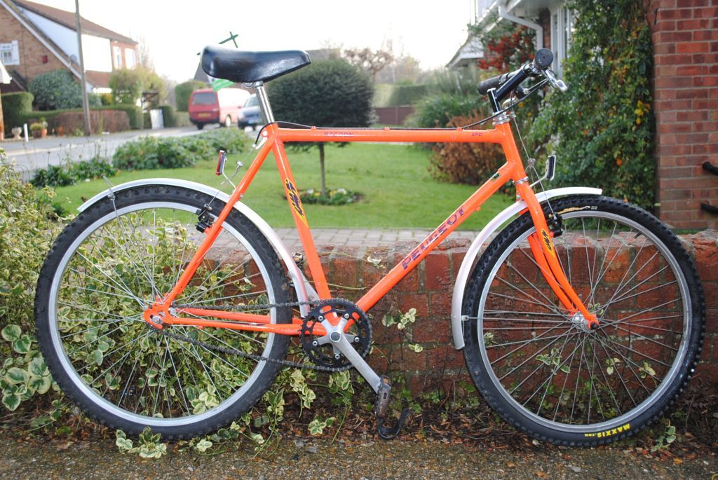

Picked up a pair of wheels this evening and they have one of those screw on freehweels (if that's what they're called)..
Not running anything with gears at the mo so am wondering how to get the chainline right if I use a singlespeed screw-on doodah..

Adjust the front on the BB.... would it be a simple case of getting a shorted spindled BB??
Or can they be adjusted by unscrewing the left side and screwing the right side further in?
This works for my single speed but I use lower than 2:1.
Dished screw on freewheeled wheel. Attach a bottom bracket lockring first then attach the single speed freewheel. The lockring spaces the freewheel out slightly. Use inner chainring as large as you can get and fit, I use a 30T. Result chainring is well inboard and freewheel is as far outboard as I can get.
The chainline is near spot on although it all depends on chainset, bottom bracket axle length etc. No redishing of the wheel for me because I'm crap at that sort of thing and spoke tensioning/wheel truing leads to maddness :lol:
