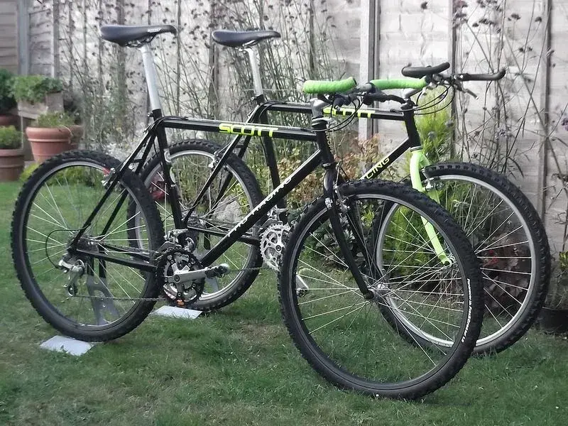

My name is Alexander, I live in Sofia, Bulgaria, but currently I reside as student in France. I am running Scott Montana 1990 restoration project.
Some history. Last summer I received almost for free one old Scott frame in very bad condition. By research over the Internet I found out that this was 1990 Montana.
Here is the same frame after the sandblasting. The aluminum seat post in the tube was different size than the original and totally stuck. After caustic soda bath it was gone.
We have now the frame after zinc and powder coated. I purchased some aftermarket Scott stickers from Australia.
After those initial steps, I knew that the frame is salvageable and I started purchasing the missing components and elements. I do not use our local market. Most of the components come from ebay.co.uk.
Now I have the following components:
- Front and rear Scott single wall rims with brand new 26” Schwalbe Lancruiser. The rear rim is equipped with Shimano FH-M18 cassette body
- Hard fork – sandblasted, zinc coated, powder coated in green. I forgot the exact RAL colour
- White Scott seat, Kalloy Uno black 26,8 seat post, I have the clamps, Jagwire cables and white housings, Shimano cantilever brakes in pristine condition, bottom bracket cable guide with bolt, front brake cantilever hanger, brand new cantilever brake pads, Shimano SL-RS40 3x8 24sp shifter set with cables, rear derailleur Shimano Alivio, Shimano Alivio brake levers BL-MC16 for cantilever brakes, Vintage Japanese Tange - Levin 1" inch BSA steel headset, Scott Pilot handlebar, stem with adapter for the Scott Pilot handlebar, Original Scott grips, Scott RC saddle bag.
