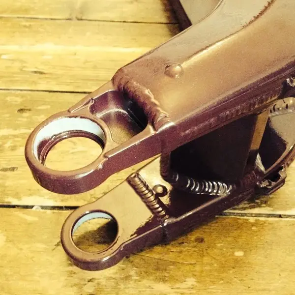

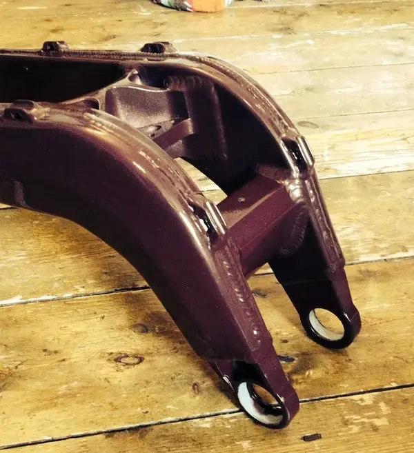

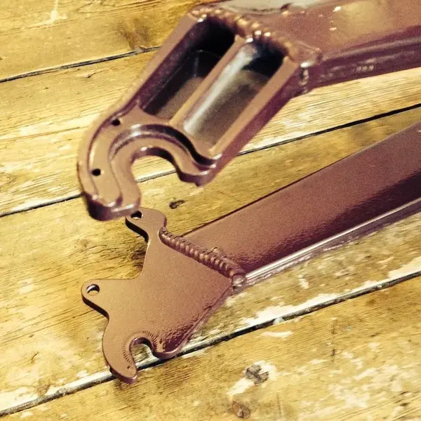

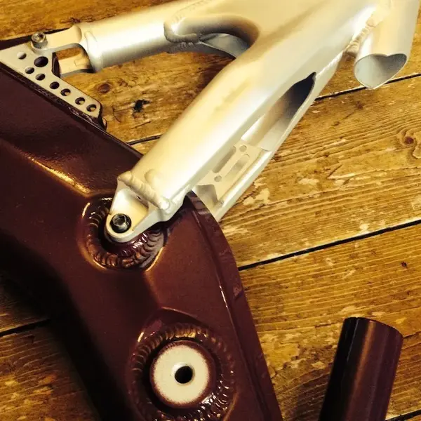

i've got a san andreas mountain cycle which i am trying to build up. the swing arm is a new (old stock) replacement from america and the front end and seat tower from a guy here in the uk. It is the last version of the frame, made by Kinesis, 2003ish? with removable shock mounts.
i need some help in finding out which bearings to use for the main swing arm. and also where i can get some washers made that go between the swing arm and the main body. my swing does not have a pinch bolt, unlike most of the frames i've seen on the internet, so i think i need press fit bearings. any san andreas owners know the code on their main pivot bearings? niche question, i know....

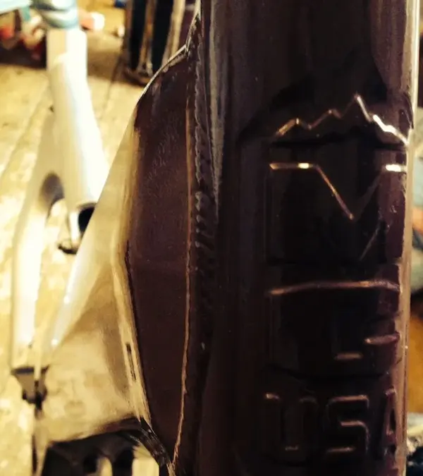

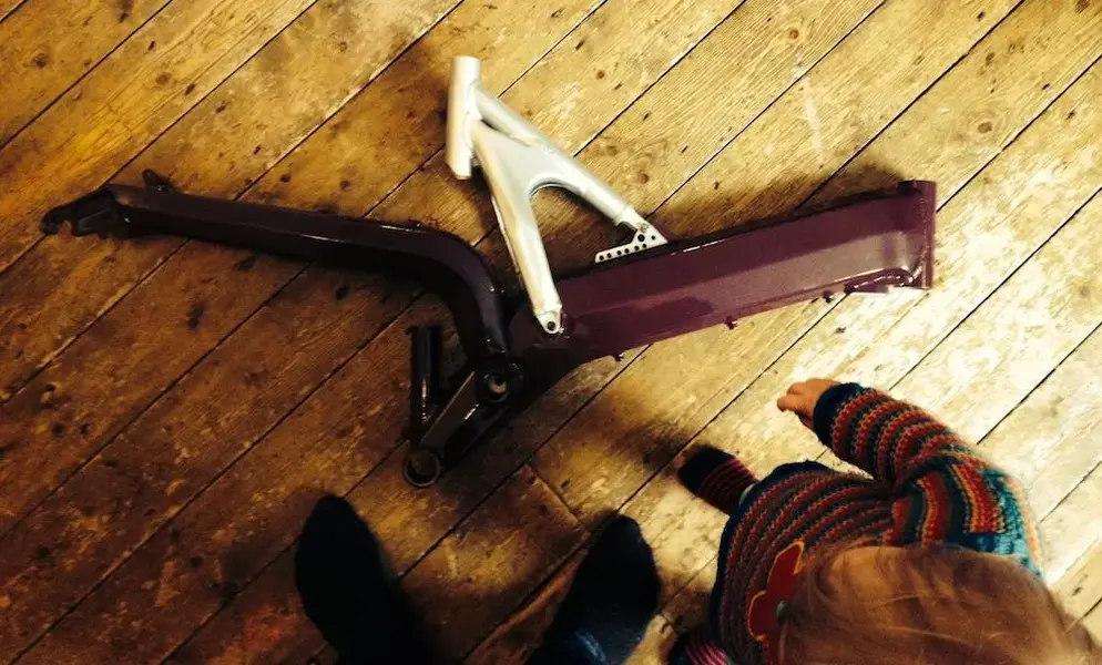

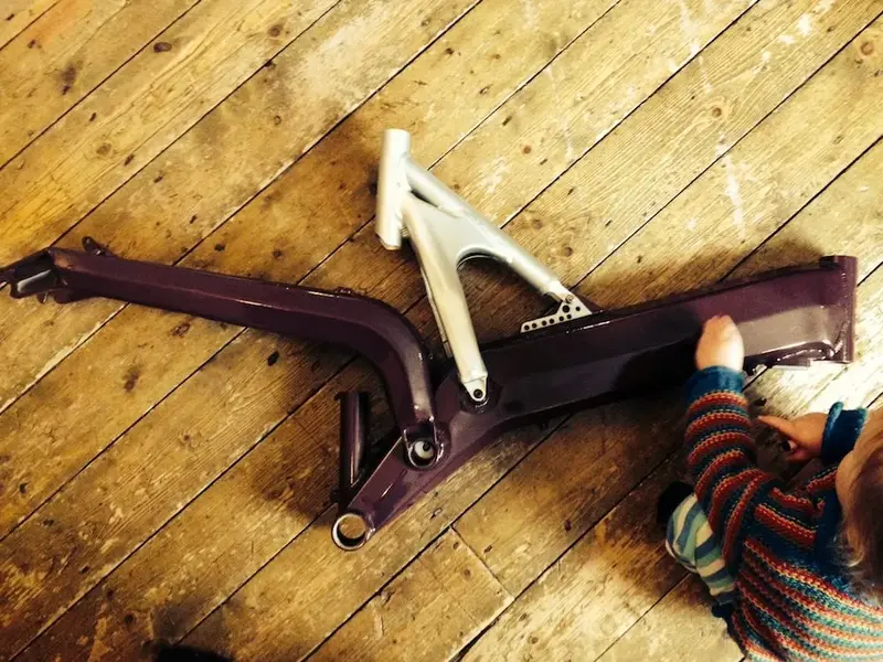

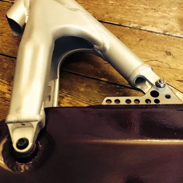

thanks for your replies. i finally got around to taking some pics ...
so the information i need to get this together now is:
1. seal bearing size / code for the main pivot? (there is no pinch bolt on the swing arm)
2. dimensions of washer that go between swing arm and the main frame on the main pivot?

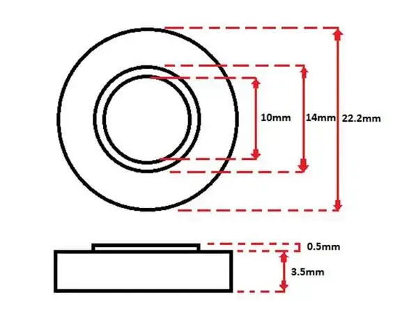

Dan Jones (through the MC facebook group measured his spare washers and emailed me a pic, included below) which is great, but i will need to get them made, as the step washer is quite specific. so i am holding off getting them done until i know the matching bearings unit.
I'm guessing there is more than one combination of washer and bearings that will work with this frame?

here's the washer diagram. does it look familar to anyone? know which bearings would fit with it?
