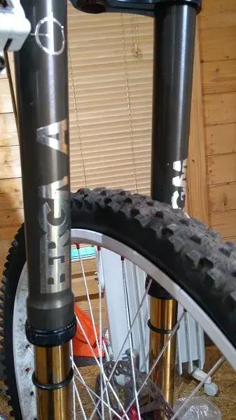

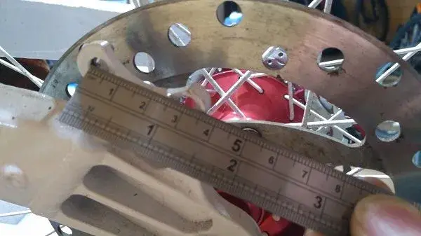

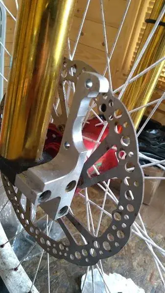

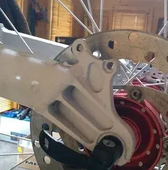

Anyone know if disc mount adaptors are available to run modern standard brakes. It's a San Andreas frame and Berga suspension forks.

That’s an interesting rear mount do you have a retro brake that fits it? It’s not a mount I’ve seen so my Guess would be a custom mount. As for the front you need to check the hole Centers as it’s either an IS (international standard) mount which is easy enough to get and IS-pm mount. Or it could be a pre IS mount (about 45/46mm across the holes) like the early bomber z1’s in which case it’s be a custom job again. But if you search for B3 on here he makes them.

I have no brakes for it, wanting to get modern brakes on it if poss. I will measure soon, thanks
FYI, the Berga... forks are actually Bergmann forks (a few of the letters are missing from the chrome decals). German 90's jobbies, look nice enough, not so sure how well they work.
