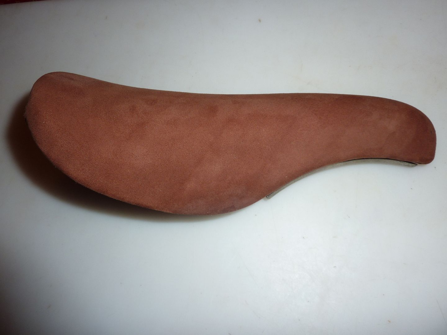

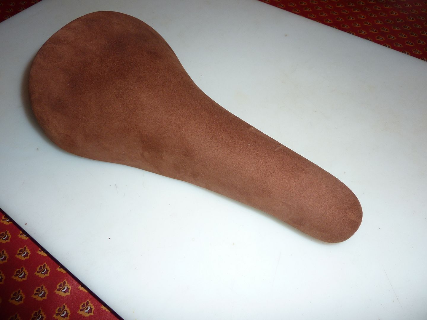

here are a few flites I did recover with a tutorial if you are handy enough :mrgreen:
( the nose and underside is quite tricky :facepalm: )
middle of the page
viewtopic.php?f=1&t=33820&hilit=flite&start=80
the latest try with a Turbo and a Concor Profil

Interesting thread! I recovered an old saddle, VI Luxe or something. Was not too difficult, result was OK but not as good as bduc61's - especially like that white Flite with the perforated leather.
