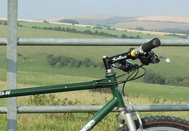

If the removeable face plate stem below is dangerous, it's been dangerous since c2000 and it hasn't killed anybody yet.
But as it is outside the recall period, I was wondering whether it is in fact held to be dangerous. I don't know US consumer protection law, but I thought it was quite tough. Would they be allowed to recall only production after 2007 if production prior to 2007 was also suspect?

I know nobody on here is actually racist, but there does seem to be a widely-held view that welding done in the USA is inherently superior to any welding done in Taiwan. I don't actually think that's true, but certainly Taiwanese welds don't serially break. If these stems are dangerous, it is surely down to something wrong with the design, not the build - and that was what I was wondering about.
My stem is visibly the same as the ones that are suspect, but it hasn't been recalled. The design is visibly spindly compared to the aluminium stems we generally see, but then that's to be expected because steel is denser than aluminium. I wonder where the breakages on them arise - has anybody actually seen a broken one?

I thought I'd ask them, and here is the (extremely prompt) reply:
Anthony
You should have nothing to worry about. It was not a question of engineering but that of some faulty material. That’s why only a specific batch was effected. And of the few we did see have an issue, it all happened right away. So if you and your friend have been riding it for 10 years, I would say you are ok. Please let us know if we can be of any more help.
Thanks for checking with us.
Eric Fredrickson
Warranty & Customer Service
Subject: Older CroMoto stem
Hi
I have a CroMoto quill stem with removable face plate that I bought maybe around 2000. The last time I saw it, there was nothing visibly wrong with it, but the bike is on long-term loan to a friend and I don't want to take any risk of exposing him to danger.
I know my stem is outside the product recall dates, but can you tell me please whether there is any difference between the design or manufacture of my earlier stem and the ones that have given trouble? Also can you tell me where the faults have occurred, so that I can inspect it more carefully there?
Many thanks
