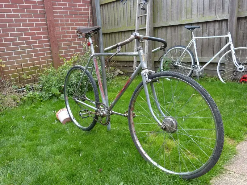

I recently acquired this Rudge. A rustbucket, but I wanted to have the wheelset (SA FM) for another project. I fitted an old 26 x 1 1/4 flip flop wheel yesterday and gave it a spin. I really like it, so I might do it up as a fixie. The frame feels light, no real lightweight tho.
I am thinking it is a Rudge Pathfinder from 1951, I will try to add some pics for ID.
Reasons for Pathfinder: alloy 25.4 seatpost, but you can feel there is a sleeve in the seat tube. My 1948 Lenton Clubman also had a 25.4 seatpost and was definitely 531 (plain).
The dropouts and fishtailed lugs seem to match.

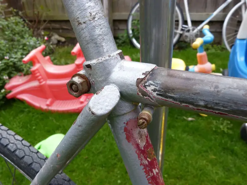

There is a brazeon under the top tube to attach a guide for the trigger cable.
Reasons for 1951: the braze on for the trigger cable mentioned above. The hubs are marked 50-10.

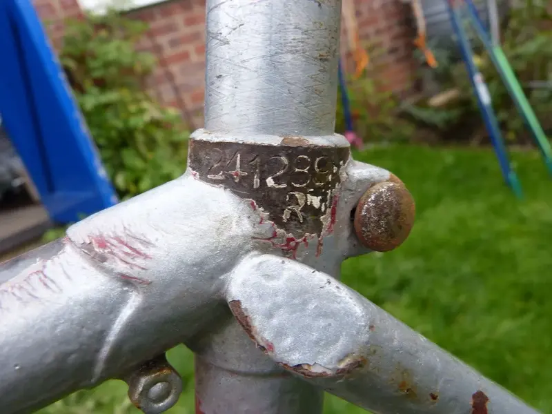

The framenumber does not match the Raleigh convention #1 as it has a 6 digit number followed by a "R". Framenumber is 241289R

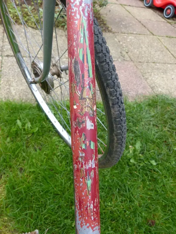

I found the remnants of a decal on the down tube, I cannot find anything like it on the web. It looks original though. Does anyone recognise this decal, it looks like it has a viking or norman in the middle...

I am particular looking for info on the frame number and the decal on the down tube.

The Pathfinders and Humber Clippers pre1950 were almost the same.
I am 90% sure it is a Pathfinder, but I expected it to have a Raleigh Nottingham frame number and the decals / transfers are a bit of a mystery.
Thanks, Rogier
Hi Rogier, that transfer looks like a Norman, Raleigh bought Norman in 1960 and Rudge in 47. I see Rudge did a Rambler for export that looks similar to yours, frame wise but earlier. I'm wondering if they are Raleigh serial numbers you have? Just a line to follow maybe?

It has a 50s Rudge headbadge, typical Rudge fork crown, looks like a Pathfinder - pls don't make it more complex than it is ;) We had the same thought process though, cause I in to Norman too. However they used very different transfers on their road bikes and stamped framenumbers on the bottom head lug. This looks more like a viking's head.

This is a Raleigh, badged like other raleighs with minor differences, nothing to do with Rudge Whitworth.
From what I remember Raleigh used the same 5/16 rear fork ends on all their brazed frames from late 30s to their demise, apart from those made in carlton works and specials, juneviles and small wheelers.
The Raleigh fixed/free rear hub was 5/16, the SA 7/16 but across the flats 5/16. This helped to stop the SA axle turning under torque load.
The octagonal head set was late 1948.
