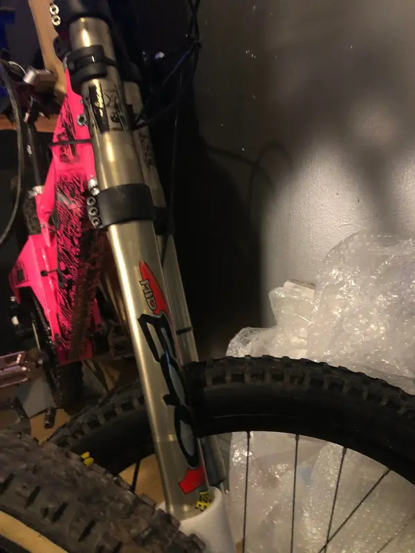

Having the same issue as spud. Magura in the Uk I think have shut down and the email doesn't work anymore ([email protected])
Any help where I can find the kit (p/no 0731167) would be much appreciated lads thx
I'm in searching Magura seals also for this fork, as I was told Magura used some Marzocchi Seals in the past!??
Does any of you guru's know more about?
