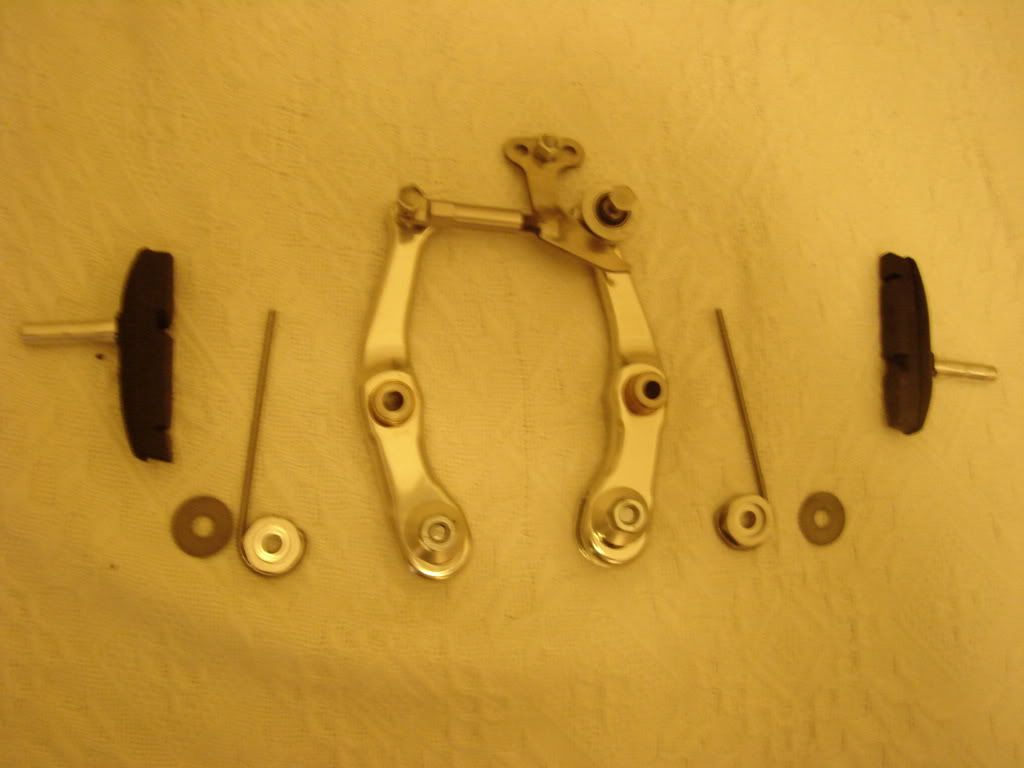

here's a pic of some WTB rollercams.
pull the lever and the cam will push the arms apart and thus force the pads against the rims. in the pic the cam is not perfectly positioned. in non operative mode the rollers should be on the flat part of the cam and when the pads just touch the rim they should be on or just behind the hump. that way the brake closes quickly and when the pads are on the rim you have really great modulation.
rollercams are lighter (at least the WTBs and early Suntours) than U-brakes and imho work better.

Rollercams were 'interesting' - they weren't as wide as u-brakes so could be used on chainstays without the risk of catching your ankles or calves on
Imagine a v-brake, but with the pivot above the brake block instead of below it. Now, where the cable comes in, instead of a hanger, there's a triangle shaped doo-dah (the cam). The tops of the brake arms have rollers on them.
As you pull the cable the triangle shape rises, and the rollers roll down the side and the arms are forced out as the point of contact widens. As the tops of the arms are forced out the pads are pushed onto the rim.
Voila! Les freins sont travailler.
When set up properly, roller cams put out a ton of stopping power. Arguably the best feeling brakes I've ever used.
