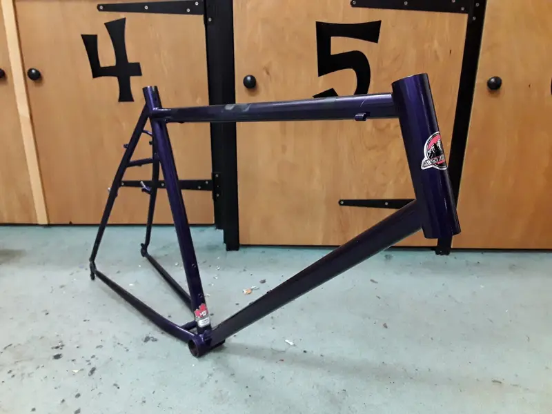

So here it is on day one.....im sure many of you remember it. Although it had already lost its Ocky stickers.

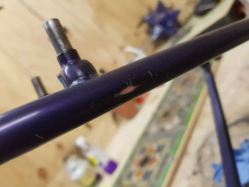

So, what to do with it? Well, the paint wasn't good enough to keep, it looked like it had spent its life with a lock on the toptube rubbing around and been lent up against every lamp post from here to timbuktu!

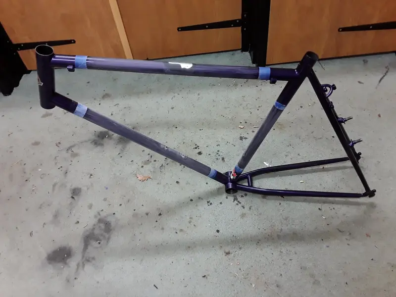

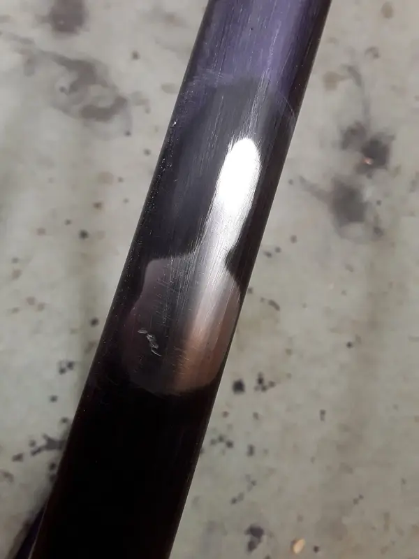

First job was to deal with the damage, so all the bad paint got sanded out, filled on the top tube and primed up.
Then (as its powdercoat) I sanded out the skuffs, touched them up with enamel mixed to the required colour and sanded them back again. Lastly i abraded the entire frame so it would take a new finish.

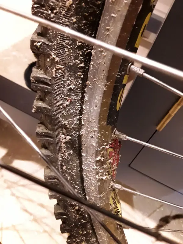

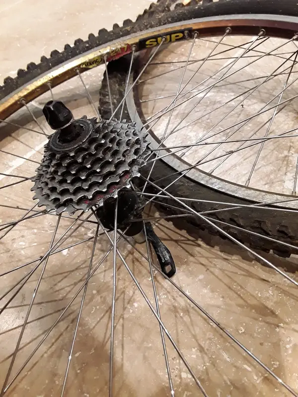

Here's the wheels i found and took inspiration from......they are a bit of a mess!

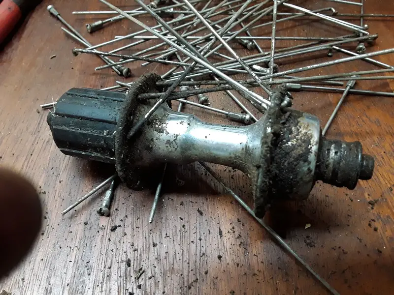

Wheels are stripped apart. Can't save the spokes.....can't even undo them!:LOL:
So its choppy choppy time.....
Front hub toast.....rear, salvageable.

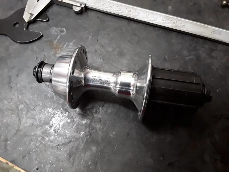

Today was about trying to get the wheels back into some kinda usable condition!
The rims are all cleaned up (jif and elbowgrease). The front hub ive treated myself to a new xt m730 36h from the lovely man at bicyclist.cc........cheers.
The rear I've rebuilt and with a good polish its come up very nicely imo.
Spokes I've got luckly......so tomorrow we build!
