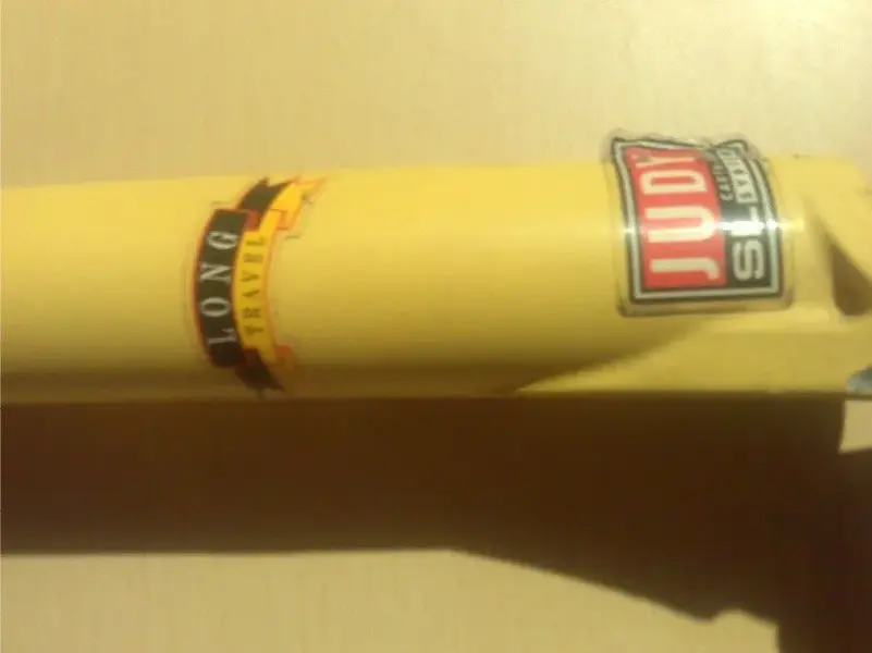

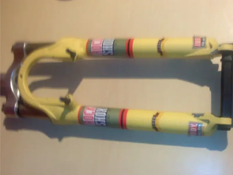

I am not really sure what year they are ? they have a normal brace on not a canti brace which is built into the lower legs, I'll do a pic and post it up , see if that sheds any light... gimme a min... :wink:

Here ya go, sorry for the pic quality... :wink:
The afforementioned SRAM site shows the length of exposed stanchion to suss' length, can't remember the dims' off the top of my head but I can email it to you from my works PC if you're struggling tomorrow AM if you pm me... :wink:
Hi Jon, the forks look the same as those in the link, but they were not bought off that fella, could it be that the DHs are 100mm travel ? the DHs are deff longer.. so I assumed that the SLs were 63mm ? :? :? :roll: :)
