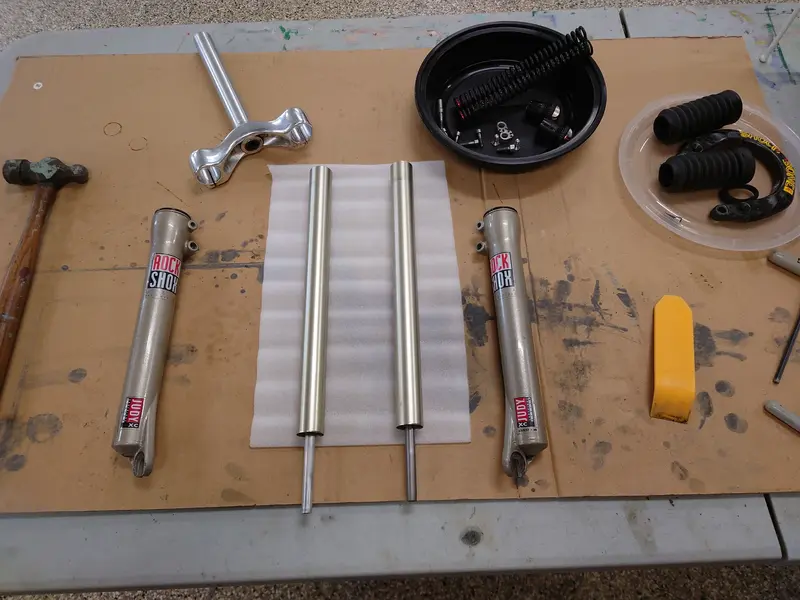

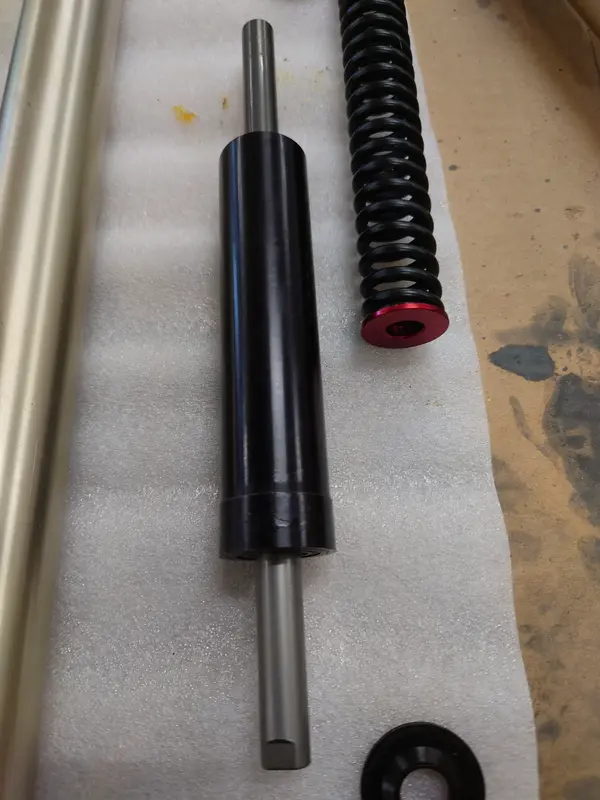

This fork came with the Bontrager I picked up a while back, but have been eyeing it for my Hei Hei. I haven't tore down a Judy in decades, but it went well, and surprisingly it's in really good shape. It has been modified, coil springs and aftermarket dampener, no markings on either. Anyone recognize them?

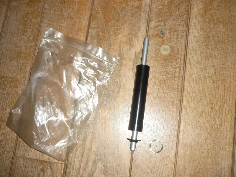

It may not be aftermarket as es did update the plastic damper to a metal one. Aftermarket ones tended to have logos on them but standard ones didn't.

I hadn't thought that it could be OEM, all the Judy's I worked on BITD had the plastic cartridge. The bottom seal weeps a little fluid with each stroke, so it needs to be serviced or replaced.
The dh came with aluminium cartridge, and RS updates were available for the xc too.
