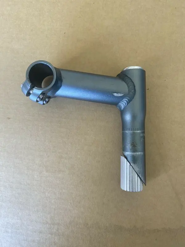

I generally avoid lightweight stuff ... even if it's modern and new. What about surface rubbing like on this stem. Thickness of the material is around 2-3mm.
Haha! I must come across as grumpy ol git...😂
I can hear that stem ticking from here...run...it's gonna blow! Just kidding!!
Should be ok....I'll send you my disclaimer..✌️
