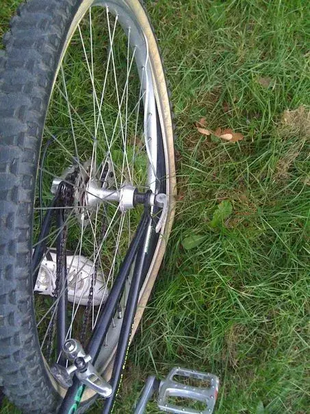

My mate RTS on a ride at the weekend.
Take a used M231 Mavic rim. 2.2 tyre. Lots of pressure. A few rutty fields.
Explosion.
Check out the rim wall - it spliced straight through the inner tube. Never seen a rim do this before.
Anyone have a 32 hole m231 for sale?

I've heard of this happening before, it's usually caused when your rims are so worn from braking that they become concave, very thin and eventually start to crack. Before you know it KABLOOIE!
