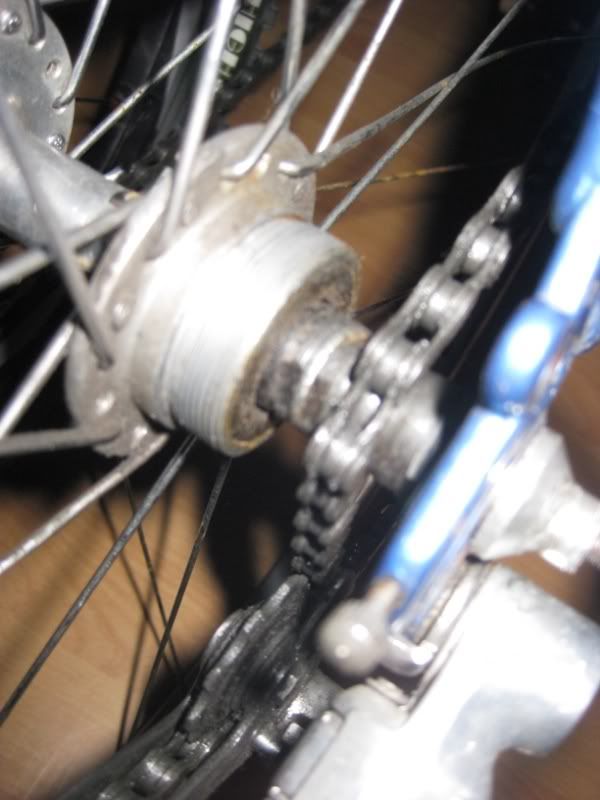

I've Just brought myself a RIH Mistral to restore, its actually in ok condition other than the rear wheel. I'm wondering whether to buy a new wheel or get the old ones rebuilt (multiple missing spokes) but 105 hubs.
However I'm unsure on compatibility, would a modern cassette run with the current r.mech/chain/shifters & cranks? or if I get the wheel rebuilt what cassette would I need? any pointers would be greatfully received.

The rear wheel just appears to need some missing spokes replacing, I could probably tackle those. Its what type of Cassette that I would need that concerns me.
The kit on the bike all appears to be 1984 Shimano 105, I would post a picture but I'm not at the magic 5 posts yet 8)
1984 sounds like UG era. In that case a modern cassette won't work. Get up a pic :)

Rear wheel:
You need a screw on cassette. Probably six speed. Possibly SJS Cycles have them or maybe Mario De Fietsenmaker in NL.
