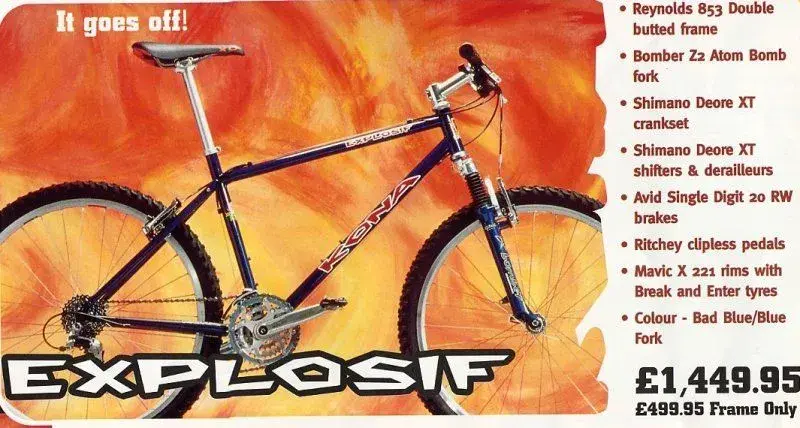

You shouldn't ever set the stem length primarily to achieve best fit. The stem length has a major impact on the steering geometry, i.e., the fundamental handling qualities of the bike. You have a longer fork than the frame was designed for, so you need a shorter stem. But if you feel your arms are stretched, then it may be that a shorter/higher stem would also help your posture.
If you look at the catalogue photo for the following year's Explosif, you will see that they had already gone over to a 105mm/15 degree stem as they worked out how to get the best out of suspension geometry. The frame geometry was exactly the same as in 97, they just changed the stems to suit the forks. As I say, that was mainly to keep the handling lively, but it also improves the riding posture.
Compared to a 120/0, a 105/15 would make the bars almost exactly an inch higher and an inch nearer the saddle horizontally. I'm not sure whether that would induce bent arms, or simply that the triangle made up of your back, your arms and the line from the saddle to the bars would just tilt upwards and backwards, i.e., your shoulders/weight would shift backwards. That is obviously a more dynamic position, in terms of ability to shift your weight about, but not so fast for head-down hammering.
I actually have four of those 98 stems at the moment and don't need them all, so I could send you one to experiment with for a small consideration.
