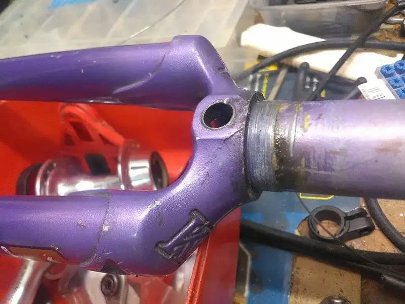

Does anyone know what different Reynolds tubed forks may weigh ? my Kenevans steerer tube has REYNOLDS engraved on it and weighs 780g with a 205 mm steerer tube , the legs are approx 26 X 20 mm at the bottom of the crown

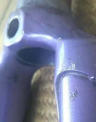

I just noticed a 531 engraving on the top rear of the right fork leg , did every tube of a 531 set have that done ?
