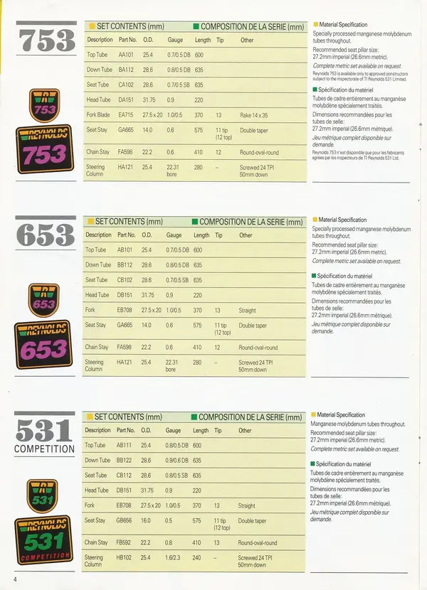

Here’s the page from the same catalogue with 653: no reference at this stage to silver soldering. I’ve posted elsewhere about the apparent discrepancy between seat post sizes, with Reynolds’ recommending 26.6 for metric tube sets, but my three metric frames are all 26.8.

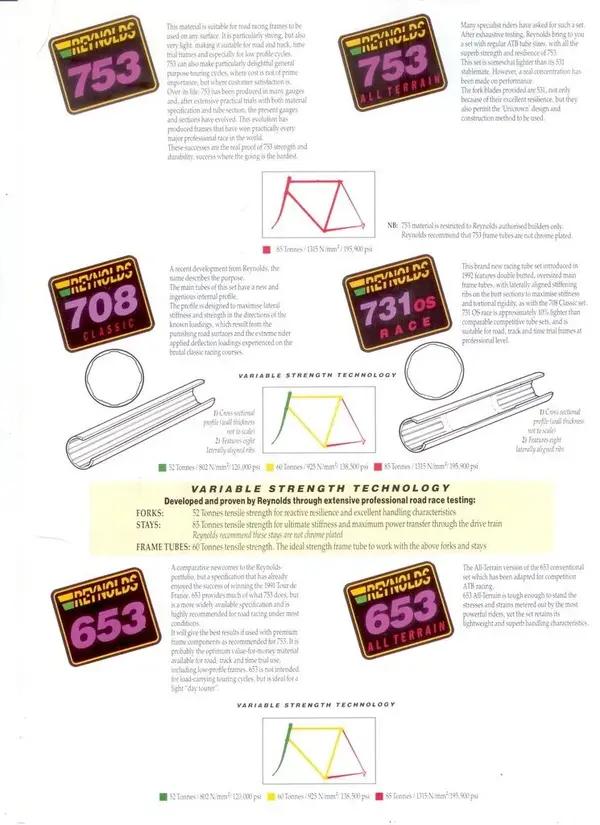

In the 1991 catalogue silver soldering is recommended for the chain stays, same tube sizes as used in 753 frames.
1992 saw introduction of 731os, another tubeset with variable strength technology.
