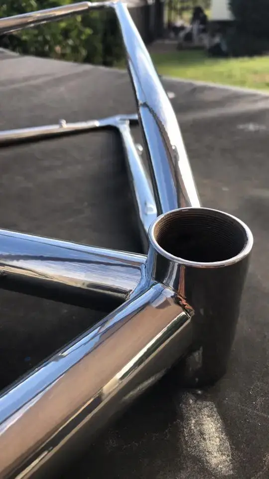

I saw the frame below recently on an Australian Facebook group - this has been powder coated in a chrome paint. Sounds mad but it looks good.
