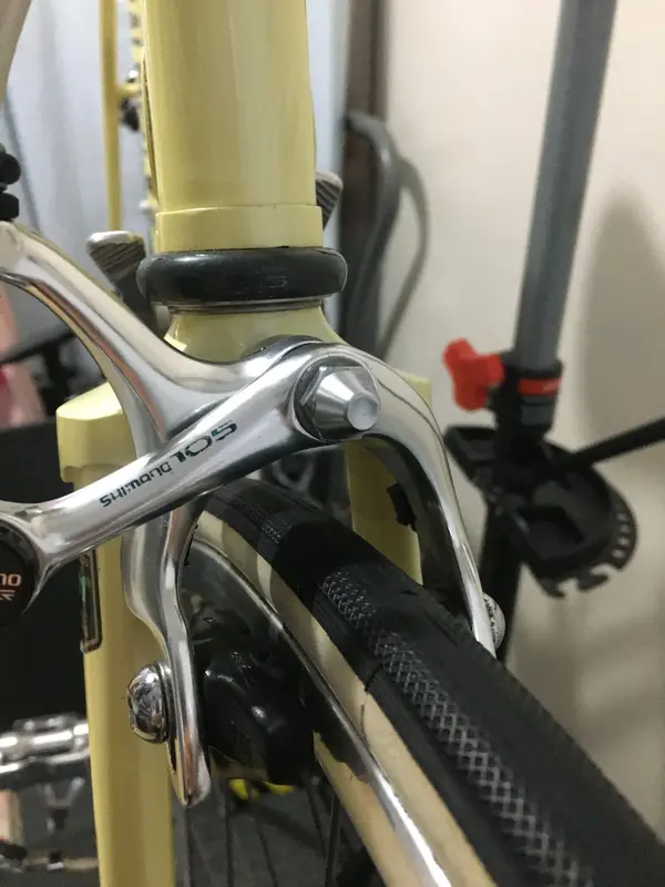

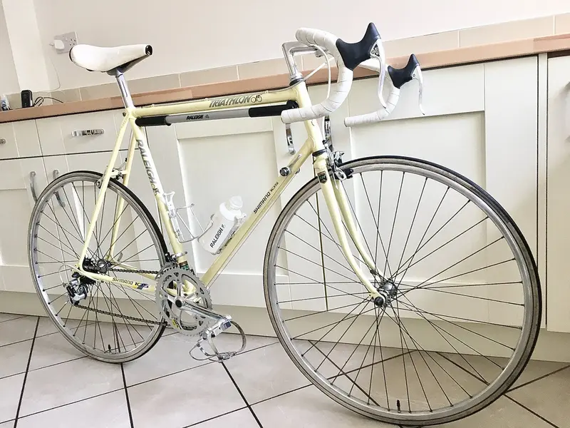

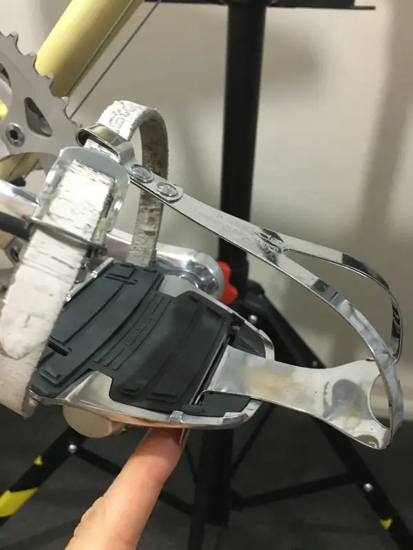

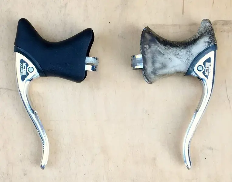

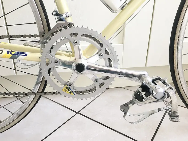

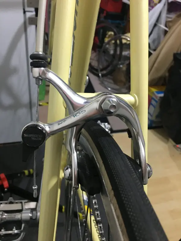

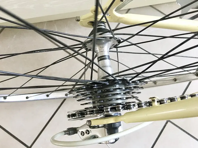

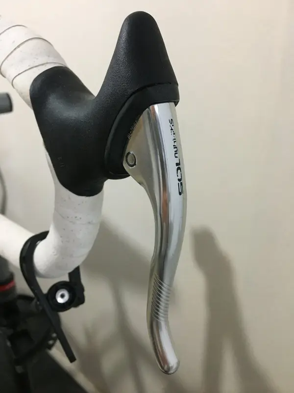

Not sure if I've put this in the correct forum for finished bike restoration (also posted in Reader's Road Bikes under the same title) as I'm new here as this was my first vintage bike restoration project, a Raleigh Triathlon road bike. Original owner from new when purchased in 1987 from Bikes & Sports, Hinckley. Reynolds 531 double butted main tubes and forks. With Shimano 105 (1050) groupset. I tried to keep it all original apart from replacing the white coloured aero brake hoods as they had perished. The tires although not original they are fitting for the bike as they are 30 plus years old. Not sure if the Cinelli handle bar tape is original. The frame was stripped down with all components disassembled into their component parts before been cleaned and polished before re-assembly, greased and re-attached to the frame. Original outer cables cleaned and flushed with GT85 and new inner brake and gear cables installed. The only parts I couldn't remove was the original cassette, as unsure on the tool required. So just cleaned it up and sprayed GT85 inside the workings so running smooth. Oh and both headset cups wouldn't come out with the headset removal tool.
