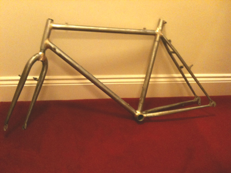

I stripped the paint and found loads of repairs, not good ones either.:
so a crack in the seat tube and the bottom bracket shell. not great.
so I decided to replace the seat tube and bottom bracket. this was fine as they are probably cromo and columbus/531. the main probelm is that the top tube and down tube are probably 753 / 653. And in spite of a years training in welding I am not ready to braze 20 year old heat treated tubing that is thin. so a new front end.

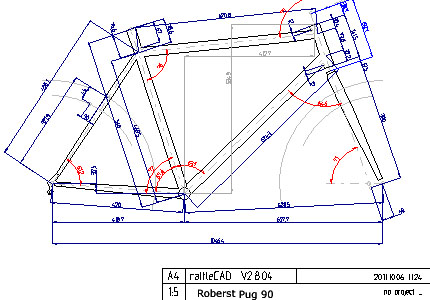

So I took all the meatsurements and did a frame design using rattlecad (free on sorceforge)
I decided to go with columbus nivachrom top and down tubes, and 531 head tube, columbus gara seatube and a silva forged cromo bb.

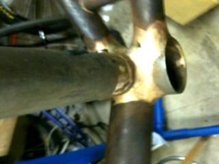

I brazed with sif 101 rod which is low temp but stronger than regular brass from back in the day. quite happy with the fillets:

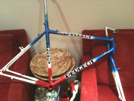

then to paint: i saw the real Gould Roberts pug on this site and saw the 1989-90 campag big and thought i would love hence the pug decals.
I had a full campag groupset waiting to go form the original planend build. the rims are campag not wolber and silver nto black and I have not put on the black stem and blcak 501 bars yet but you get the pucture.
So yeah its only a small part vintage roberts and the rest is circa 2011 so maybe I should list it in the "post 98" section. but I though you might have a look at the worst most extensive rebuild I have ever done. any yes is would have been cheeper and quicker to write it off and start from scratch but I guess I saw it as a challenge or what i can do in a small shed on my own. I hope no one finds it an insult to the real ones but rather a nice piece of homage.
