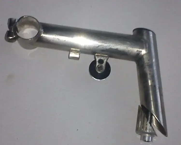

Oh yes this is annoying me, what is a quill stem? Is it what I have and what was on all old bikes? The threaded headset?

Secondly the picture below shows a Quill stem used on virtually all bikes until the mid 90's when they were pretty much superseded by the aheadset and ahead stem ;)
