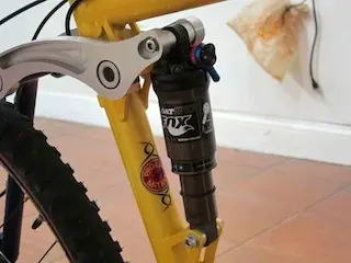

My Fox RP23 arrived yesterday so I was able to complete the installation.
It took a couple of minutes.
This is what it looks like now:
