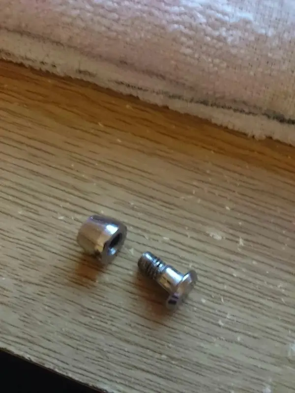

S shrewedpunter Dirt Disciple Jan 19, 2015 #1 It seems the bolt end of my deore rear mech is ruined.. any ideas where i might get a suitable replacement tomorrow in the shops? Maybe i could bodge it with a bolt and nut from homebase lol Attachments webwxgetmsgimg (2).webp 68 KB · Views: 328
marc two tone Retrobike Rider Feedback View Jan 19, 2015 #2 Re: Is it from a DX mech? Most of the time these kind of fixings are quite unique to model and fit just right. I would ask about for one robbed from the same mech(tell us which) somebody must have a battered one.
KermitGKona88 Gold Trader Overbury's Fan Feedback View Jan 19, 2015 #3 Re: I have used a M5 x 10 stainless domehead bolt before, you just need to use an allen key in the bolt when you start tightening, just until it bites
